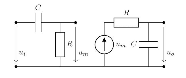

I consider the band-pass filter of the following configuration (the ##u_m## is a voltage controlled voltage source):
The transfer function is
$$K_1(p)=\hat{U}_o(p) = \frac{p}{RC(p+1/RC)^2} = \frac{\omega_c p}{(p+\omega_c)^2}, \quad \omega_c=\frac{1}{RC}.\qquad (1)$$
Now I connect ##n## such filters in a row (using the ##u_o## of a previous one as a source for next's ##u_i## by means of the controlled voltage source), which means that the transfer function becomes
$$ K_n(p)=\frac{\omega_c^{n}p^{n}}{(p+\omega_c)^{2n}}. \qquad (2)$$

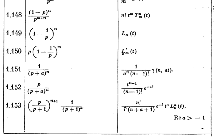

In some operational calculus handbook (russian one, not sure if it's reasonable to link) I find
I assume there is no problem in substituting ##n## for ##2n## in ##1.152##:
$$\hat{S}(p)=\frac{p}{(p+a)^{2n}}\div \frac{t^{2n-1}}{(2n-1)!}e^{-at}=s(t). \qquad(4) $$
Note that all of the derivatives of ##s(t)## up to ##n-2## order are equal to zero at ##t=0##. Finally I get the impulse response (using previous statement)

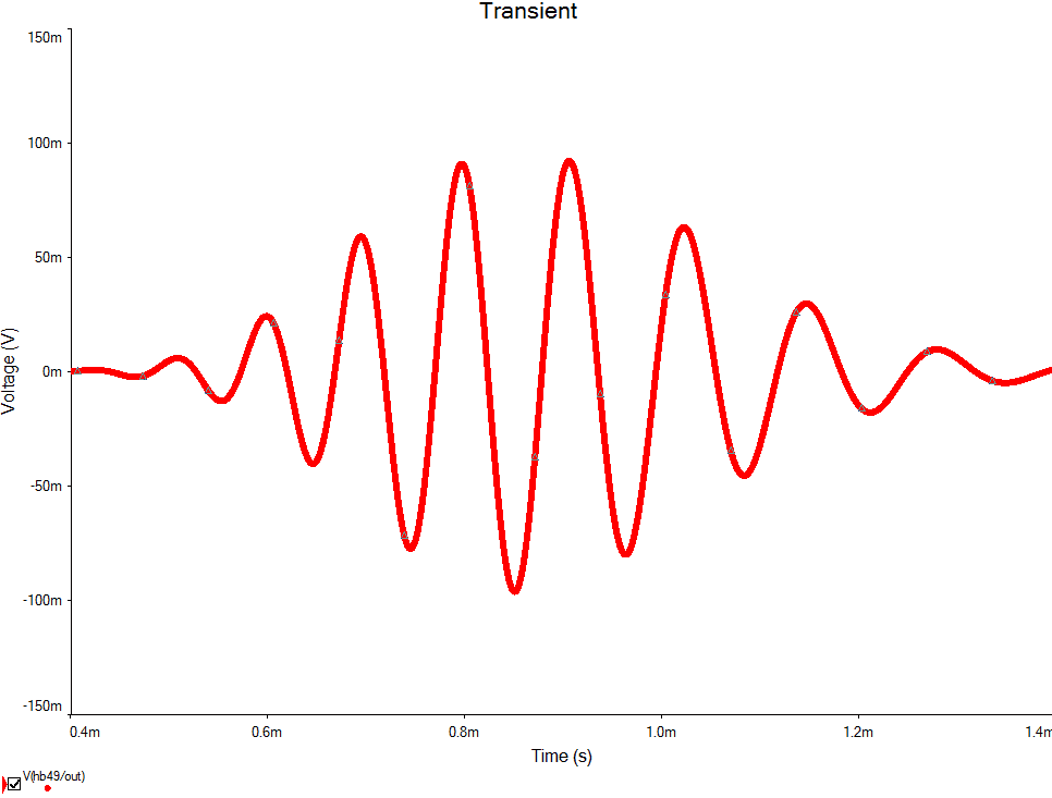

It is clear at least for ##n=1##. I plotted it in Matlab for ##n<30## (because Matlab refuses to calculate derivative of a higher order) and it looks
the way the simulation in NI Multisim gives. Here's ##n=49## (in Multisim):
It's predecessors (smaller ##n##'s) look alike, just having "less waves". WolframAlpha inverse Laplace suggestion (check my previous post) for transient response works for ##n\approx30\div50##, which is not satisfying. I assume there's something wrong with my reasoning, so I ask you to help me to find the mistake. Been struggling with it for a while and I need a fresh look on the problem. Thank you in advance.

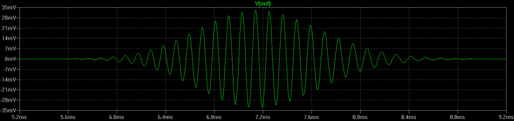

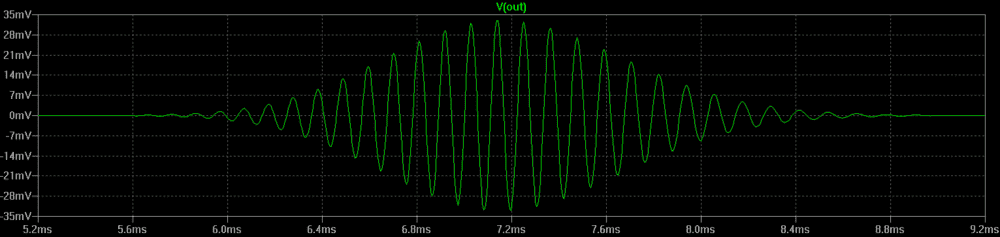

Examining the red trace impulse response. The oscillation has a period of about 0.1m sec which is a frequency of 10 kHz. That tells me the R and C were specified as something other than unity.
The risetime of the envelope is about 4 cycles which tells me the Q of the cascade is about 4.
The group delay of 49 stages is about 0.85 msec, or 17.34 usec per stage.
I assume it is stimulated by a narrow impulse at time = 0.
You have synthesised a narrow band delay line.
The transient response is very close to what I would expect for the cascade of 49 modules.
Why do you not trust your model?
Was the stimulus a unit area impulse?
Can you tell me what values of R and C you used to generate the red trace transient response?

There was no limitation seen in Multisim, 49 is just an example, yet it was the biggest I went because it's quite hard for my PC to run simulation with that many filters. Speaking of Matlab, I think it's the "large numbers" limitation, since it is clear that all of derivatives exist and can be calculated directly.

I seek for transient response, so it was stimulated by Heaviside step function ##1(t)##
My reasoning brings me to the fact that transfer function yields transient response (instead of impulse one), which indicates that either my reasoning is wrong, or the inverse Laplace transform table has a mistake.

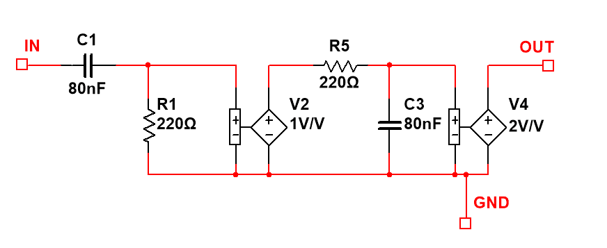

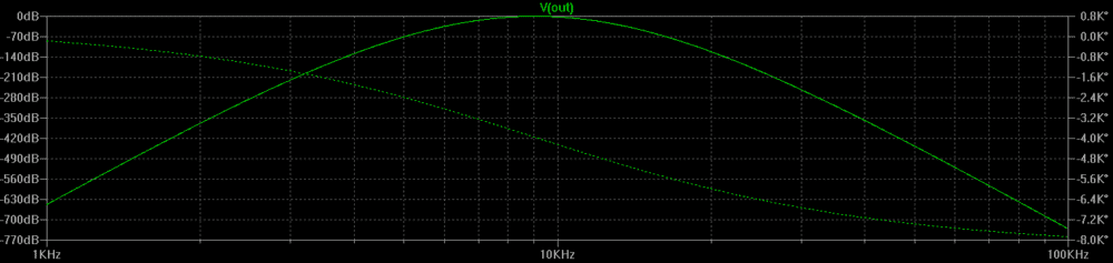

Here's one cascade

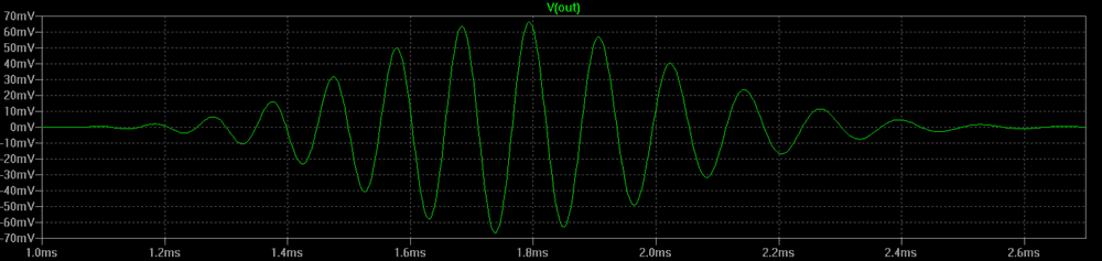

Simulation of 49 cascaded modules with LTspice agrees with your transient response.
Stimulation is a 1 volt step at time = 0. PARAM Cx=80n Rx=220R

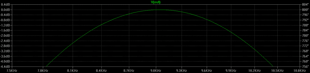

Zoom in on response shows; Centre frequency = 9.040 kHz Group delay = 862.70 usec
Bandwidth between -3.01dB points = 2.1642 kHz
Transient response; Total computation elapsed time = 0.341 seconds.
Transfer function; Total computation elapsed time = 0.198 seconds.

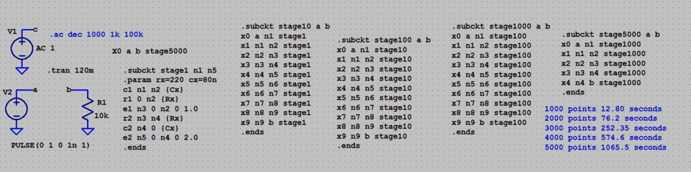

How many filters can you add more? Is it possible to go for ##n=100,200##? It would be very interesting to see.
For 100 modules it produces the transfer function in 0.374 seconds.
-1.3k dB at 10 kHz; -1.5k dB at 100 kHz.
-535.7u dB at Fo, so there is still some dynamic range.
The transient response takes 0.469 seconds to compute.
The transient response of 200 modules takes 0.769 seconds to compute.
  • Wow

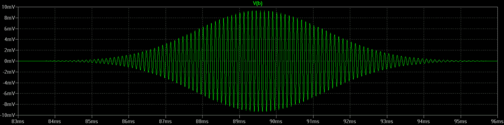

This is getting silly. The graphical interface is now a bit slow.

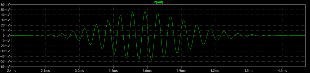

The transient response for 400 modules takes 4.497 seconds to compute.
Baluncore said:
This is now getting silly. The graphical interface is now a bit slow.
It is clear now how the impulse behaves with the growth of ##n##. What would you recommend to try to compute ##(7)## formula in the post? As previously mentioned, Matlab spits out 0 for ##n>30##, but I really want to see if it's the same as your results for ##n=100,200,400##.
room_ said:
What would you recommend to try to compute (7)(7)(7) formula in the post?
You arrived at the transient stage by mathematics and questioned if it was correct. If a mathematician had followed you, they might have fallen into the same hole(s). I arrived at the same transient stage via a different path, which to some extent confirms your result.
It appears to me that your Hn(t), eqn 7, would need to be evaluated the hard way. Not being a mathematician leaves me at a disadvantage so I would need to go study for a day or two before writing the code. If you could expand eqn 7 into a computational process, that would help.

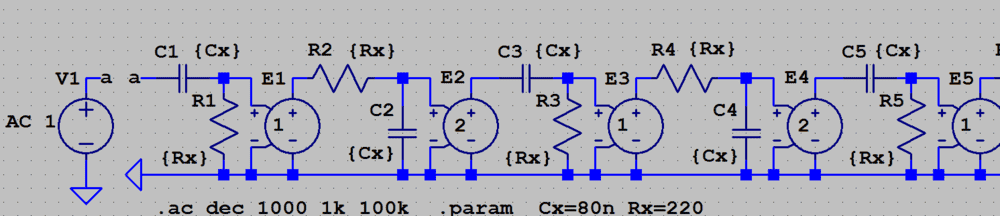

I wrote LTspice subcircuits, nested with local parameters for the model. By eliminating the analysis of graphical connections I took the number of stages cascaded to 5000, (without hitting a limit). The result is what is expected. As the bandwidth is reduced, frequencies on either side of the pass-band that would sum destructively to cancel the centre frequency, become closer in frequency, so more cycles at the centre frequency are seen over a longer period. Also, the available step energy falling in the narrower bandwidth is reduced, so the output amplitude falls.
