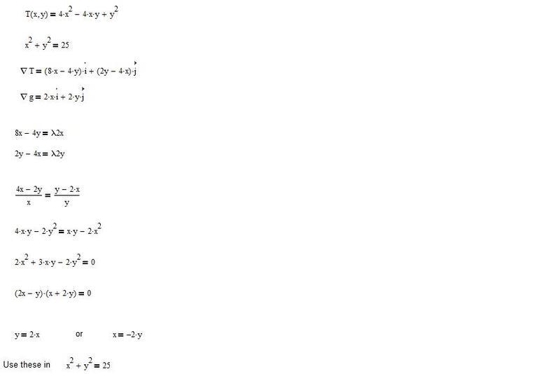

The temperature at a point (x, y) on a metal plate is T(x, y) = 4x^2 − 4xy + y^2 .
An ant, walking on the plate, traverses a circle of radius 5 centered at the origin.
Using the method of Lagrange multipliers, find the highest and lowest
temperatures encountered by the ant.
T(x,y) = 4x^2 − 4xy + y^2
gradient of T = (8x - 4y)i + (2y - 4x)j
g(x,y) = x^2 + y^2 = 5^2
gradient of g = (2x)i + (2y)j
gradient of T = (lambda)gradient of g ----> lambda=#
8x - 4y = #2x ---->1
2y - 4x = #2y ---->2
# = 4-4y = 1-4x
what am i going to do next?:confused:

you have a function to optimise T(x, y) = 4x^2 − 4xy + y^2, against a given constraint x^2 + y^2 = 5^2
i've got max= 45 and min=5..
am i done it right?
  • Typed working for a Lagrange multiplier problem: T(x,y) = 4x^2 - 4xy + y^2 with constraint x^2 + y^2 = 25, gradients, system 8x - 4y = 2λx and 2y - 4x = 2λy, then factorised (2x - y)(x + 2y) = 0 giving y = 2x or x = -2y, with 'Use these in x^2 + y^2 = 25' below.
Yes, what you have done so far is correct. But that certainly does NOT give "max= 45 and min=5"!

i've checked my calculation already...
when y = 2x,
i substitute into x^2+y^2=25
i got x=+-(5)^1/2
when x=-2y,
i got y= +-(5)^1/2
so.. i got my critical points..
---> [(5^1/2) , (5^1/2)]
---> [(5^1/2) , -(5^1/2)]
---> [-(5^1/2) , (5^1/2)]
---> [-(5^1/2) , -(5^1/2)]
my critical points are correct?:rolleyes:
