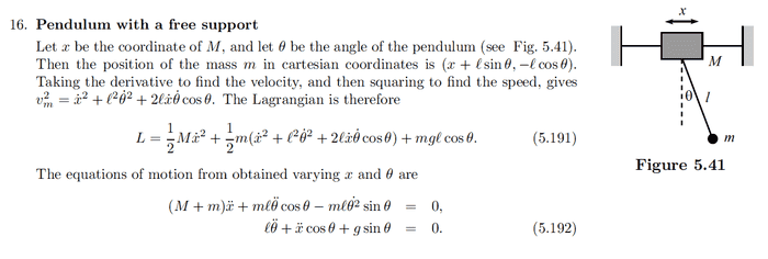

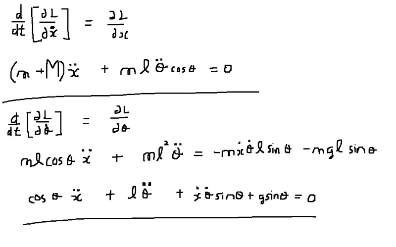

I don't understand where the third term from the first equation of 5.192 come about.. as clearly L doesn't depend on x at all, so ∂L/∂x should be zero.
The second and third terms both come from differentiating the [itex]m\ell\dot{\theta}\cos{\theta}[/itex] term...you get two terms because there are two [itex]\theta[/itex]'s in it.
ah that makes sense! thanks a lot!
