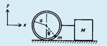

Hello. I have some problems with making Lagrangian. I need your advice.
1. Homework Statement
I have this situation:
Diagram of a bead of mass m on a circular hoop of radius a, rolling on a floor, connected by a cord over a pulley to a block of mass M, with x and y axes and angle theta marked from the vertical.
Consider the circular path is intangible and without friction. I have to find Lagrangian for coordinates x and θ.

The origin of the coordinate system is at the center of the initial position of the circular trajectory.
I understand that the fist part is kinetic energy of big cube of mass M in coordinate x.The second part is kinetic energy of bead of mass m in a circle in coordinate x.

I suggest you write the position of the bead (both horizontally and vertically) as a function of the generalised coordinates. Differentiating it wrt time will give you the velocity.
