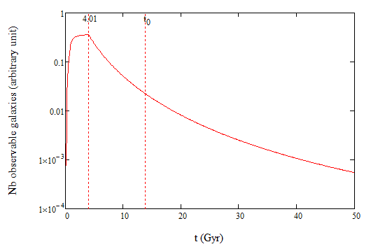

The number of visible galaxies is to vanish in the long-term future with the ##\Lambda##CDM model (book and papers of L. Krauss et al). I am interested in a quantitative study on how the population of galaxies decreases; I could not find one so I do it myself:
The scale factor: ##\displaystyle\frac{a(t)}{a_0}=(\frac{\Omega_{m0}}{\Omega_{\Lambda0}})^{^{^{1/3}}}\sinh^{^{2/3}}(\frac{t}{t_{\Lambda}})## with ##t_\Lambda=\displaystyle\frac{2}{\sqrt{3\Lambda c^2}}##, ##\Omega_x## the densities, and ##\Lambda## the cosmological constant.
The density of matter: ##\Omega_m(a)=\displaystyle\frac{\Omega_{m0}}{\Omega_{m0}+\Omega_{rad0}(a/a_0)^{-1}+\Omega_{\Lambda0}(a/a_0)^3}##
The particle horizon: ##d_p(t)=a(t)\displaystyle\int_{0}^{t}\frac{cdt^\prime}{a(t^\prime)}##
The event horizon: ##d_E(t)=a(t)\displaystyle\int_{t}^{\infty}\frac{cdt^\prime}{a(t^\prime)}##
These horizons are shown in the figure:
The two horizons cross at t=4.01 Gyr.
Let be ##h(t)## the smallest of the two horizons: ##h(t)=\min(d_p(t),d_E(t))##. The number of visible galaxies is then: ##V(t)\sim \Omega_m(a(t))h(t)^3## and this is shown on the figure below:
The number of visible galaxies was maximum at 4.1 Gyr when the two horizons cross. Today it has decreased by a factor of 16, and at t=37.2 Gyr, it will have diminished by another factor of 16.
Is my calculation correct?

In your earlier threads it was pointed out to you that this isn't true, unless you have a very specific meaning in mind (that you don't seem to be using here). Since you're back with essentially the same question, can you please indicate what did you find unconvincing in the arguments given so far? Or at least define what you mean by 'visible' galaxy, and explain why do you think the intersection of the two horizons has anything to do with it. If you think Krauss is making an argument to the contrary, please provide a specific reference, so that we can discuss it.

Can you also explain what you mean by a galaxy vanishing (or equivalently, being observable)? That is, when you want to count the number of visible galaxies at a given cosmic time, do you mean galaxies that are within the event horizon at that moment?; galaxies whose light reaches the observer at that moment?
I can't reconcile either of these with what you wrote above, so maybe you mean something else?
So I am interested in counting the galaxies that are observable at t, i.e., whose light reaches the observer at t.

Thanks for your replies.
The EH today is at 5.0 Gpc, z=1.8, so my calculation is completely wrong.

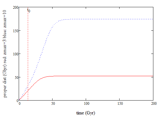

Here is a new one: I consider the proper distance to a given redshift as a function of t:
##d(t)=\displaystyle\int_{0}^{z_{max}}\frac{cdz}{H(z)}##
with ##\displaystyle 1+z(t)=\frac{a(t)}{a(t^\prime)}##, a generalization of ##\displaystyle 1+z=\frac{a_0}{a(t^\prime)}##.
One has ##H(t^\prime)=\displaystyle\frac{2}{3t_\Lambda}\frac{1}{\tanh(\frac{t^\prime}{t_\Lambda})}=\frac{2}{3t_\Lambda}\sqrt{\frac{(1+z)^3}{\sinh^2(t/t_\Lambda)}+1}## and the graph:
The number of visible galaxies, ##V(t)\sim \Omega_m(a(t))d(t)^3##, is shown in the figure:
So the number of visible galaxies up to zmax=3 or 10 is to increase by 1000 in the next 50 Gyr, and will sharply decrease after that.
The same calculation with a dust universe, ##a\sim t^{2/3}##, ##\Omega a^3## constant, yields ##V(t)\sim t##.

I should probably think about this a bit more, but at the first glance this looks kosher, and kinda neat!
On second thought, this can't (?) be right.
You've set up the max z at values already observable today. Any additional galaxy starts being observable (as CMB) with z higher than that, and no single galaxy ever reduces its redshift, as the scale factor always increases. So the census shouldn't grow. It should be already decreasing, as galaxies currently with z<3(or 10) move to higher z's with increasing scale factor.
The proper distance to zmax as a function of t is increasing with t (because H(t) is decreasing).
So d is larger at later times and this allows to catch more galaxies. But they are dimmer than at earlier times.
