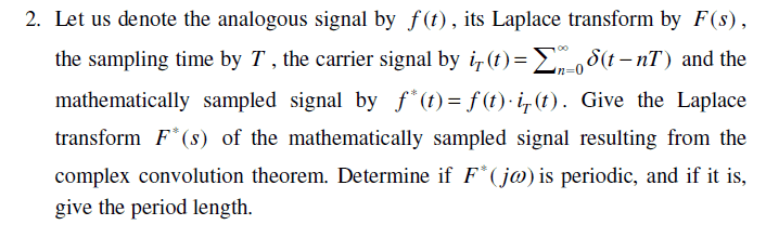

Laplace transform, sum of dirac delta
The discussion centers on the Laplace transform and its relationship with Dirac delta functions and Z transforms. Participants express frustration over insufficient university resources and explore the integration of delta functions, noting that they yield specific values in integrals. The connection between Laplace and Z transforms is highlighted, particularly how substituting z=esT can derive the Laplace transform from the Z transform. The conversation also touches on poles in the context of Laplace transforms, emphasizing their significance in determining system frequency responses. Overall, the thread provides insights into the mathematical relationships and concepts necessary for understanding these transforms.

All I can think of is that integrating or in other words summing the dirac delta functions for all t, would be infinite? None the less the laplace transform exist since its asked for in the question and i don't know what formulas to use...
Well the Z transform of the given signal is Z{1, 1, 1, 1...} = z/z-1. (I think)
But Z transform and laplace transform are two different things.
Also it mentioned poles in the question.. I have no idea what it is talking about. I am so frustrated that my university doesn't provide me with enough material to possibly learn what they ask for.
Thanks a lot for any help it would be much appreciated.

The area under a delta function is 1. So if you integrate across a delta function, you will get 1 where the delta occurs. In an integral containing deltas, the deltas will be picking out values of the integrand at specific instants.
The dirac delta function is defined in terms of a limiting process. One possibility is a rectangle whose width approaches zero but whose area is kept constant at one. This is why the delta function has the area property mentioned above.

They are probably challenging you a little ahead of covering the material. It's good to exercise the thinking muscle :)
When you integrate that sequence of deltas inside the laplace integral, you will end up with an infinite sum of exponentials. The hint provided suggests trying to find a closed form sum for that sum and then I think you will see the poles they are talking about :)

Thanks, that was a great tip. So far I figured out that the laplace transform is the sum of e^(-snT) for n=0 to n= infinity (hopefully). However I went to wikipedia about geometric series searching for the formula of this sum but I couldn't find that formula. Could you possibly help me with the sum? Thanks a lot :)
I found the final answer to be e^sT / (e^sT - 1). Is that correct?
Yes that looks right. Next you need to locate the poles.
*********You can see some connections between the Laplace transform and the Z transform now.
A continuous time signal f(t) sampled and Laplace transformed is equivalent to taking the Laplace transform of f(t)×iT(t) (iT is the sum of deltas in the question). This ends up being the infinite summation:
f(0) + f(T)e-sT + f(2T)e-sT2 + ... + f(nT)e-sTn + ...
The Z transform of the same sampled signal is:
f(0) + f(T)z-1 + f(2T)z-2 + ... + f(nT)z-n + ...
You should notice you can get the Laplace transform of the sampled signal from the Z transform by substituting z=esT
In fact you did this once already... You found the Z transform of a sampled step function starting at time=0 in your first post z/(z-1). If you were to sample a step function in the continuous time doman, you would get a sequence of deltas. You just found the Laplace transform of a bunch of deltas to be esT/(esT-1)

faen said:
Would it be right to say that the poles would be those values of s such that e^sT = 1?
yep! poles

I think this answer should be right based on the definition of the laplace transform, but the question asks me to use the convolution theorem which I don't know how, and also implies that the laplace transform of f(t) (which would be F(t)) should enter the equation somewhere. Also I don't know how to find the period of this signal.
Now they want you to find the frequency content of the sampled signal by setting s=jw in the Laplace transform of the signal.

You could probably answer the question this way but it is *not* the way you should do it because there is another simpler way to understand this that you need to see and the question is steering you toward. I only went through this exercise so you would not be too confused. The Laplace representation of the signal you found as an infinite summation is equivalent to this other representation you are about to find.So, start again:
We have a sampled signal whose Laplace representation is:
L[ f(t) Ʃ δ(t-nT) ]
Look at this time domain multiplication in the frequency domain. A time domain multiplication is the same as convolution in the frequency domain. So suppose you have F(s) and its Fourier representation F(jw) and the Laplace of the deltas (infinite sum of exponentials) and its Fourier representation (set s=jw, your exponentials appear as ? with phase ?). Convolve them. First assume the bandwidth of F(jw) (+ve and -ve frequency) is smaller than the width between the Fourier exponentials of the delta sample train. Then you will see there's a problem if F(jw) has larger bandwidth but either way the result will still be periodic with the same fundamential period.EDIT: I fixed the Fourier series explanation above
Thank you for your answer, it was very enlightening. The first part is understood. The only thing I still need to understand is how am I supposed to convolve F(jw) and the laplace transform of delta's? Should I do the integral over Those two multiplied? Will there be any shift in the variables in that integral?
Do it graphically on the magnitude spectrums. Since f(t) is arbitrary you can assume F(jw) has some bandwidth that is centered on 0 Hz (keep in mind real signals have +ve and -ve frequency components). During the graphical convolution keep the delta spectrum in place while the F(jw) spectrum is moved. Assume a small bandwidth for F(jw) at first because if it is too large, a bad thing will happen (aliasing). Then try a second pass with larger bandwidth to see what happens. Both will be periodic with the same period but one is harder to construct. If the sample rate is increased, the distance between the deltas in the delta spectrum increases which allows wider bandwidth in F(jw) without aliasing. This is where the nyquist sampling theorem comes from.
