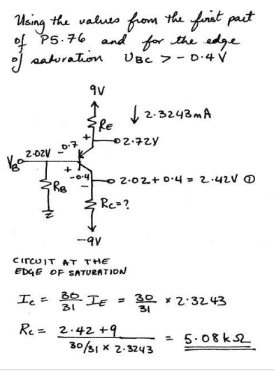

The discussion centers on determining the largest resistor value for a BJT to remain in active mode, given a transistor with a current gain (β) of 30. The key inequality derived is Vc - Vb > 0.4V, which is crucial for maintaining the transistor in active mode, as saturation occurs when Vce reaches 0.2V. The participants clarify that for a silicon transistor, the base-emitter voltage (Vbe) is largely constant, influencing the voltage relationship between the collector and base.
- Understanding of BJT operation and active mode conditions
- Knowledge of transistor parameters, specifically β (beta)
- Familiarity with voltage relationships in BJTs, including Vce and Vbe
