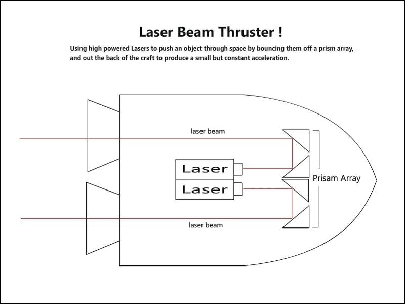

I just had this thought while watching a video about the EM drive...basically using 2 lasers to bounce them off prisms inside an object to push the craft through space at a small but constant acceleration...could someone explain why this would not work?...please see attached image :)

Using a beam of EM waves is a possibility for obtaining thrust but it requires a vast amount of power. An on board laser isn't good value as you don't need such a well collimated beam and you can get more power out of other sources.
PS you may as well fire the lasers straight out of the back. It would achieve the same amount of momentum transfer (Newton's Third Law and reaction) and wouldn't involve heating up the prism reflectors.

yea I realize you wouldn't get much thrust, but these kind of devices never would, like a solar sail...plus the idea for using prisms would be to get a double bounce effect...but you would probably have to angle the second prisms, so you get more fwd push than sideways push...but anyway...i'm an animator, i just wanted to understand why this wouldn't work! :)

The drive can only deliver the same amount of momentum change as the momentum in the beam that's leaving out of the back. All the other 'bounces' cancel each other out. Shame but that's Newton for you.
There are a lot of discussions about this topic on PF and elsewhere and sometimes the Physics isn't always well understood. But, as you are hardly likely to be investing all your money in such a system, it's not that desperate.

One of the bounces is canceled by the recoil of the laser. With ideal refection it would be the same as simply pointing the laser back. But in reality it's worse, due to partial absorption at the reflector.
