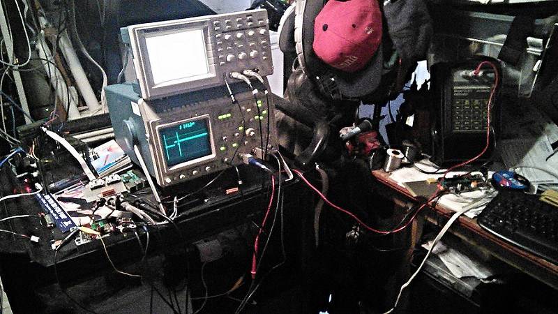

Yeah. I was also gonna suggest “embedded systems” I coded a barcode scanner and that was low level C against it’s BIOS ROM. Not much fireworks there! :)
EDIT: I also coded dictaphones and set up the backend completely with RDBMS. They were sold to Chinese hospitals close to nationwide. Made my boss a wealthy man but all I got (besides a good salary for an autodidact) was an AUDI A3. After I installed Microsoft Outlook Server I was told what Microsoft takes for the same task. I refused to show up for a couple of days after that, driving around in my new car, seething! :woot:
