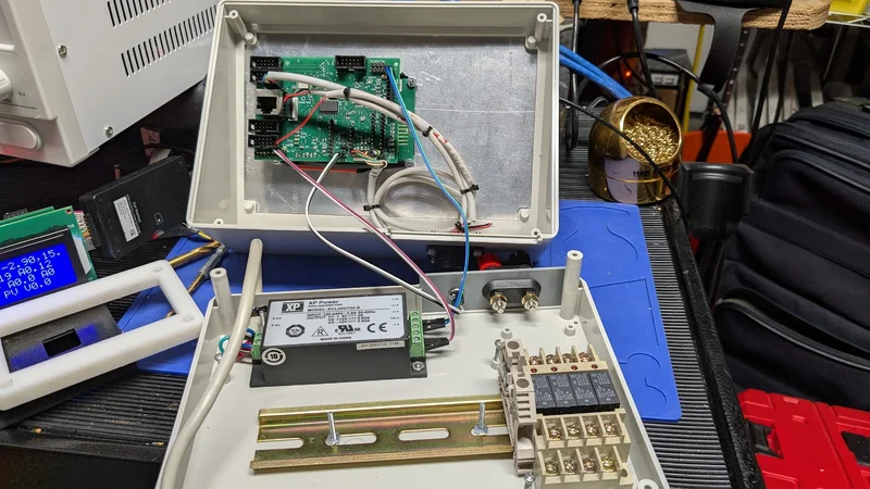

I also think you should look a micro-controllers/embedded systems to gain experience with ASM programming and embedded system design. Embedded systems are much more than low-level programming. IMO spending a lot of time and energy on assembly language for complete programs is a waste of resources for most people in the field. You effectively need to create your own HLL to program larger programs with ASM so it's usually better to use an HLL like C that allows easy integration with ASM for hardware specific functionality.
My current home project requires PIC18 firmware for a board I designed with just a little ASM for things you can't do in C. The PIC assembly is simple and direct.
https://github.com/nsaspook/mqtt_comedi/tree/fixes/bmc
Reading PIC18 device registers in main.c

This PIC device talks with a Linux system using a kernel protocol driver module that talks to a Orange Pi via SPI.
Driver daq_bmc
https://github.com/nsaspook/mqtt_comedi/blob/fixes/daq_bmc/daq_bmc.c

A C program on the Linux machine uses the driver to send and receive data using MQTT to Home Assistant for monitoring and control of a small Solar Energy testing system.

Looks exciting. I understand there are a lot of DIY projects out there making use of these cigarette pack-size mini-computers like the Raspberry PI and others. Those might make a good place to start a project writing a device driver or something similar.
  • #71

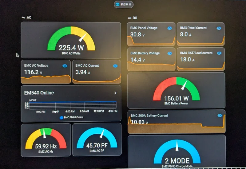

It's mainly a redesign of a larger system already in use. The Raspberry PI and its kin make excellent platforms for small embedded system if you need interactive control and/or compute capabilities in a small package.
Solar panel ADC front-end for processing low light-level signals.
