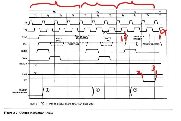

Good old days, That's what I studied and the Z80 and 8085. Around 2-9 show the read write instruction interrupt and other cycles.

I don't think that is all true, usually takes a few clock cycle for each instruction like memory fetch. I have not read any datasheet for a long time, But when I was designing these before, the old one like 8080, Z80 and 8085 all need a few clock cycles to read, write, out and in. You need to first send out the address(see 1 below), make sure it's stable, then the /Wr goes low to write in 2 below, then goes back high(3) BEFORE the (4)address starting to change to ensure you have enough hold time so it won't accidentally change while /Wr is still low to avoid accidentally write to another location. It is a sequential operation. You can see there are two clocks to generate all that. Each M1, M2 etc are each instruction cycle. For 8080, looks like it's 3 clocks per instruction. BUT one cannot speak for any other processor. then you can have wait state.
I don't know whether the term system clock is the same is machine cycle. Usually I don't think so as you cannot depend on the system input clock as there is propagation delay to generate the clock that CPU can rely on. Remember particular CMOS circuits, the prop delay drift a lot due to temperature change. So relying on the edge of the input system clock is NOT a good practice. They rely on the internal clock to compensate the temperature drift. See the two 'phi' clocks in the timing diagram. Those are internal generated clocks that are temperature compensated.
But this is really electronics. I think if OP is NOT CS, the class might be the wrong one to study. You don't use your toe to tough and feel the water, you either dive in, or stay away. Unless programmer work with low level assemble language, most programmers don't even have to know all these.
This is CPU specific, I won't say anything until I see the specific CPU and read the datasheet.

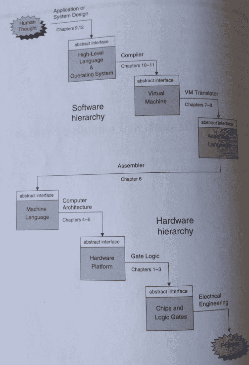

Thank you guys for your various responses.
Maybe it helps if I clarify my background or what I hoped to gain from such a course.
I studied physics (MSc) and I am now enrolled in a PhD program to applied mathematics. During my physics studies, I used C++ as well as Python and Matlab for numerical simulations and some data science. During my master thesis I was using a cluster, where I submitted the same simulation thousands of times with different random seeds to then statistically average over the results (which means I also know how to deal with submission scripts). In the first year of my PhD I did a small MPI workshop (never used OpenMP though).
My research is going to focus on distributed algorithms for Machine Learning, i.e. Machine Learning on HPC systems. What's more, my supervisor is involved in an interdisciplinary program that researches future exa-scale HPC technologies (from algorithms, to hardware, and possible applications in science and engineering) and he would like me to get involved as well.
Obvious ways for me to improve are certainly getting better at C++ (including MPI and OpenMP) and get more experience in using clusters or other HPC systems. However, I also thought it might be useful for a guy like me to understand how these systems operate on a hardware level, i.e. how processors or memory work. At least on a basic level. The course did not list any prerequisites, but the material seems to be very superficially covered, yet the CS students seem to draw more information out of the lectures than me (unless they already knew part of the material...).
My standing in the world of CS can be illustrated by this diagram:
I know about the highest level: How to use a computer, how to use high level languages and so on.
I know about the lowest level: The semiconductor physics, how a transistor works, and how logic gates are made.
I don't know nothing about the middle.

This put a lot more perspective to the whole big picture. What you asking about the clock and stuff has NOTHING to do with physics and very little to do with even electronics or C++, it's really a field of it's own...Digital and hardware engineering. Though it's a huge field and plenty of jobs. It is definitely worth your time to study into this no matter whether this will help your project or not. This I cannot comment as I am not familiar. I am not a programmer, I was an EE and manager of EE for decades. I just come here begging for help in learn C++, this is my crossword puzzle for retirement. I just need something more challenging for my mind.
