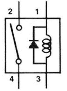

@Vatech -- Any time you drive a relay primary coil, you need to be sure to add a kickback protection diode for when the coil is opened (if it is not already a part of the coil drive circuit).
Relay schematic showing a coil between pins 1 and 3 with a flyback diode across it, and a normally open switch contact between pins 2 and 4.
https://www.circuitstoday.com/types-of-relays

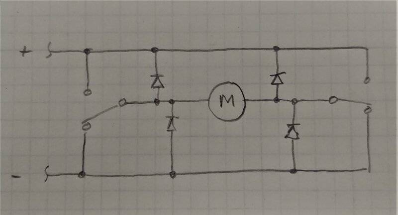

Your relays will momentarily disconnect the motor wire from any connection while it is switching*. The motor inductance will then create a voltage spike if it was previously energized. You should always provide a path for the motor current to flow somewhere.
So, what I would try first is adding 4 fast recovery diodes, 2 on each winding as shown below.
Hand-drawn H-bridge circuit on graph paper: a DC motor M in the centre, with a switch and diode on each side between a + rail at top and a - rail at bottom, each switch with a flyback diode across the motor.
* some relays will momentarily short all of the contacts together when they switch, but these aren't common, and wouldn't be used in a circuit like this.

I don't believe it is the relay coil causing the problem. It is the motor inductance when a relay switches or the brushes bounce. The two relays make a full bridge. As suggested by @DaveE the voltage spikes could be caught by adding a bridge rectifier to the circuit. The + goes to the positive supply, the – to the negative rail. The AC terminals are connected to the motor terminals.
However the supply rails have inductance also, so they need the 1000 uF capacitor to catch the inductive pulse energy.
Power supplies are not designed to work backwards, holding the output voltage down. There needs to be an over-voltage clamp for the supply rails to protect the LEDs.

The approach by @DaveE is the most straightforward and likely the most effective to protect both the LEDs AND the relays.
The LEDs are probably being damaged by the reverse voltage from the motor when it turns off (disconnects from the supply). This could be several hundred volts, whereas the reverse voltage rating of LEDs is a few volts.
The suggested configuration will also help protect the relays by diverting the voltage spike to the supply voltage.
Another possible approach is to wire a diode in series with each LED individually, and also wire a diode reversed polarity across each LED; but the approach by DaveE would be simpler.

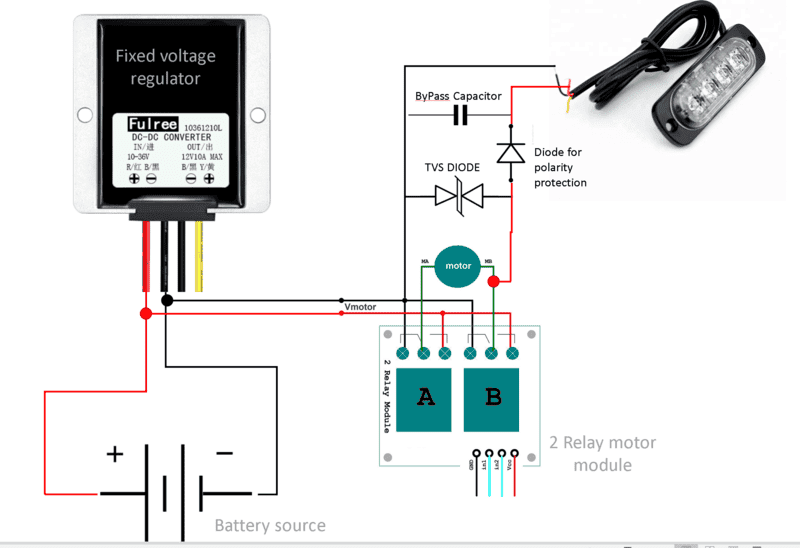

I will follow the advice by @DaveE and @Baluncore . If you agree with the connection diagram Please let me know
1) Should i use Tantalum, Ceramic or Electrolytic Capacitor (1000μF)?

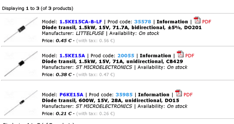

2)Do you agree wit the use of TVS diode(transient voltage suppression diode)? and if yes , should i add Unidirectional OR Bidirectional? and is 15V a good selection?
THANK YOU ALL FOR HELPING ME
Wiring schematic of a 12V LED strobe module driven by a 2-relay motor module, powered from a fixed voltage regulator and battery, with a bypass capacitor, TVS diode and polarity protection diode labelled.
That wasn't our advice. But, sure you can do that. It's not what I would do but it's better than your first version. It will probably work.
Electrolytic. 1000uF sounds OK. I would also add a ceramic 0.1uF in parallel with the electrolytic, but you can probably get away with leaving it out.
See the first paragraph. TVS diodes are easier to specify than varistors with tighter tolerances. But you will still be clamping at higher voltages than simple clamp diodes back to the supply. The other issue with TVS diodes is that you have to be careful to choose one that can absorb the energy you will put into it during clamping.

If you can't read the datasheets and pick your own, then I'm not sure you should use them at all. Plus, we don't really know about your worst case battery voltages.
Look here: https://www.digikey.com/en/products/filter/tvs-diodes/144?s=N4IgjCBcpg7AzABiqAxlAZgQwDYGcBTAGhAHsoBtcEAXRIAcAXKEASQDtGCBzAgJxABfEmACcADlEoQ6SNnzEylEMjogmLAMqM%2BAS3bchJALQAmabJ0BXReUhUArLWEhjT6DMy5CJO1QBs5iT%2BECTwzi7m9iCMAG54AAQAJrqkSQR4zkA
Anyway, I'd choose a bridge rectifier, not a TVS diode.

Dear @DaveE , can a bridge rectifier protect from overvoltageas like the TVS will do?
i found the following TVS diodes available in my country
Product listing of three transient voltage suppressor diodes: 1.5KE15CA-B-LF bidirectional 1.5kW 15V DO201, 1.5KE15A unidirectional 1.5kW 15V CB429, and P6KE15A unidirectional 600W 15V DO15, with prices and stock status.
And, should i use Unidirectional TVS or Bidirectional TVS?
Dear @Baluncore , i see you moved the capacitor and added a second Diode in parallel with the TVS diode
This is out of my field, i am not an expert on electronics , but i have to implement a project that involves a lot of electronics. Thats why i was not sure how to connect your suggested schematic between the motor relay and the power line, if @Baluncore you could modify my diagram would be helpful
I don't trust TVS diodes. When I think it needs one then I could do better by stopping the transients being produced in the first place. The four diodes in the bridge rectifier do just that. They only conduct during transient voltage excursions. Because the high voltage spikes produced by the motor transients are caught by the bridge, the relay contacts will not get burned by the DC arc each time a relay switches off.
The second diode in parallel with the LED module is a cheap investment. It prevents fast negative transients from reaching the LEDs. For negative spikes the parallel diode is duplicating the TVS. The TVS is not essential if the bridge and the 1000 uF are present.

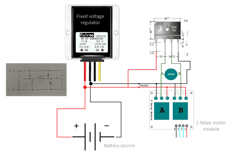

Thank you. Then i will not use TVS. Dear @Baluncore & @DaveE , is the folloowing diagramm correct according the use of bridge rectifier?
Wiring diagram of a 12V battery supply feeding a fixed voltage regulator, a 2-relay motor module (A and B) and a DC motor, with a hand-drawn H-bridge schematic showing a motor between two switches and four diodes.
That is correct for the bridge.
If you use the bridge you must use the 1000 uF across the motor supply.
