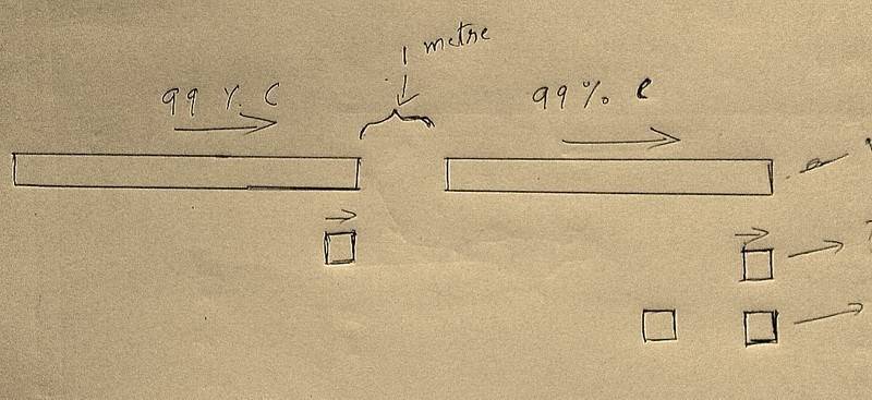

Consider two iron rods of about 10 metres separated by 10 metre. They are in series position and not connected in anyway. If the rods are passing nearby an observe with a velocity of 90% speed of light, then what would he observe?
1) does the separation between the rods (ie 10m) undergo length contraction?
2) What must the velocity of the rod if it appears half of its original length?
3) at that speed do every object appears half of its original length?
4) what will happen if these rods are connected with a tiny there's? Do the whole system appear contracted?

But here the observer is at rest and the rods are moving. I thought space contracts only when the observer is in motion
From the below picture can you show me the answer?
no
a space interval contracts whenever it and the observer are in relative motion
remember, the contraction is as measured by the observer
if he measures an interval (or eg a rod in that interval) as being 1 metre when it's stationary, then he measures it as less than 1 metre when it's moving
Your question is ambiguous. When you specify the length of objects and the separation between objects, you have to state the frame in which the dimensions apply. There are three different ways your question could be interpreted:
A) You could mean that the two rods are 10 meters long and separated by 10 meters in the frame in which the observer is at rest and therefore they are already traveling at 90% speed of light.
B) You could mean that the two rods are 10 meters long and separated by 10 meters in the frame in which they are at rest and the observer is passing nearby with a velocity of 90% speed of light and then you transform to the rest frame of the observer. (This is the way all the previous responders assumed you meant.)
C) You could mean that the two rods start out at 10 meters long and separated by 10 meters in their own rest frame and then the two rods are independently and identically accelerated to a velocity of 90% speed of light and pass by an observer who remained at rest in the original frame.
So depending on which scenario you mean, the rest of your questions will have different answers.

This setup is moving at 99.999999999% of c with respect to YOU. According to your prediction If the distance between my rod and the rod ahead of me contract, then I'll reach the end line before it ticks 1 second in YOUR STOPWATCH!
You can think in another way too
What if there is NO rod in front of the First Rod?
Try this:
1) Write down the coordinates of the two events "I am at the start line" and "I am at the finish line". Use the Lorentz transforms to find the coordinates of these two events for the observer at rest relative to the track. That covers the case in which there is no second rod in front of the first rod.
2) Now suppose that there is a second rod in front of the first. Do the same calculation for that one. Use this and the result from the previous step to calculate the distance between the rods according to the observer at rest relative to the track. You will see that distance is contracted.

  • #38
Trojan666ru said:
What tiny tim said is wrong
The distance between the rods won't contact
No, that part of what tiny tim said is correct (most of what he said is correct, only that one very small post wasn't).
You can write the worldline of the endpoint of any rod as ##(t,x)=(t,p_i)## where p_i is the position of the i'th endpoint in the rest frame. If you do a Lorentz transform on that then you can get the worldline in the primed frame, set t'=0 and see the distances. You will see that they all contract.

The at-rest observer can calculate the length of a rod by taking the time at which the front of the rod passed over the starting line of the track and subtracting that from the time at which the rear of the rod passed over the starting line. That gives us the time it took for the rod to pass that point, and we multiply that by the speed to get the length of the rod.
The same technique works to get the distance between the rods; we just use the times when the back of the leading rod and the front of the trailing rod pass the at-rest observer (or anything else that is at rest relative to him).
I really really strongly suggest that you try these calculations for yourself.
