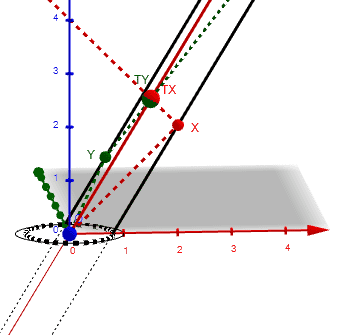

What I'm trying to wrap my head around is, what are they supposing was length contracted in their setup? The light itself? Can someone shed light on how they interpreted the situation? (in plain words please)
These visualizations might help:
Here is a (2+1)-d spacetime diagram (a position-vs-time graph) of the Michelson-Morley experiment.
All light signals are sloped at 45-degrees.
Without length-contraction (in the first diagram),​
light signals at the origin event emitted along the two arms and reflected by the mirrors​
are received at distinct events TY, then TX.​
The time-difference depends on the velocity of apparatus, as they expected,​
in violation of the principle of relativity.​

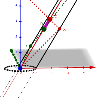

With length-contraction (in the second diagram)​
[the separation of the worldlines marking the ends of the X-arm (along the relative-velocity axis) is shorter],​
the signal along the relative-velocity axis has a shorter round-trip time so that​
the reception events TY and TX are now coincident, as experimentally observed,​
in accord with the principle of relativity.​
