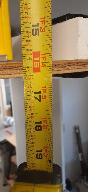

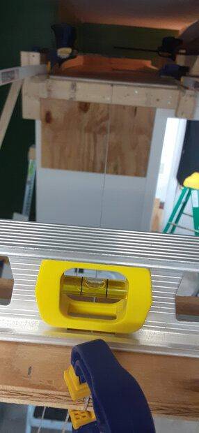

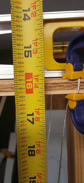

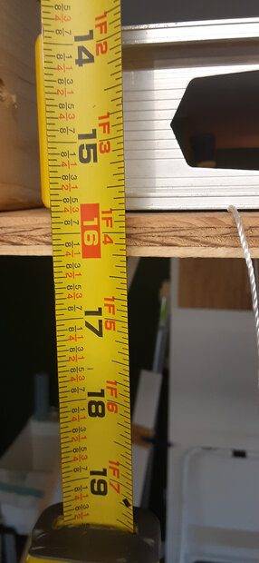

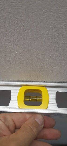

Hi All,
I received good insight from a previous post, https://www.physicsforums.com/threads/pulling-a-heavy-load.1015640/#post-6637181, now that I'm at the point of expanding the drawer support on the ceiling, I ran into the following.
How is it that my level says it's leveled but the tape measure tells me that the distance from the ceiling to the board's left corner is off, by about a 1/4 of an inch, from the right corner of the board; and in-case you're wondering, the ceiling is also leveled.
Any ideas as to why or what I'm doing wrong or missing here?
FYI, the string you see in the "center measurement - ceiling to board" photo is to align and mark the center point to the ceiling, where I'll be attaching the hardware to support the drawer's extension. I placed a string on the other two measurement photos, as well, so I could get as leveled a reading as possible; overkill perhaps, but every fraction counts.
Peace, board's level readingceiling's level readingcenter measurement - ceiling to boardleft measurement - ceiling to boardright measurement - ceiling to board

What do you know about the sensitivity of your level? And what about the precision of your reading?
For example, this level sensitivity is 0.133 in/ft - 38min/0.1in. This means that the bubble would move 0.1" for an angle of 38min (0.633°). For a 26" distance between 2 points, it would correspond to a 0.288" difference.
From what I understand, the human eye cannot see a 0.02" (0.5mm) movement of the bubble, which corresponds to a 0.058" difference over a 26" length (with the level presented, that is).
