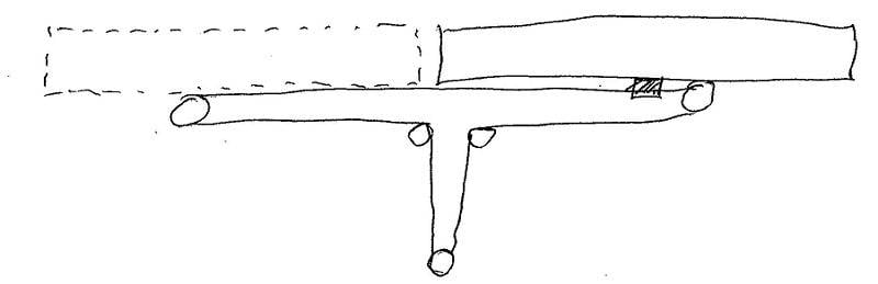

You don't give any details on available space and obstacles, so take this as a conceptual suggestion. Five pulleys and a rope, with a block attached to the ends of the rope. The block is attached to the drawer. The lowest pulley gets the rope down (or up, or off to the side) so that you can pull on it. The rope is tensioned either by how it is attached to the block, or by making one of the pulleys adjustable. You could put a crank on any pulley that has 180 degrees of wrap. That pulley would be a V-belt pulley to get better grip on the rope.

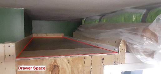

Photo of a garage overhead space with a plywood platform outlined in red, labeled Drawer Space in red text, sitting on a wooden frame beside green-painted walls and wrapped insulation.
this is the space available, 8' Deep by 26" Wide

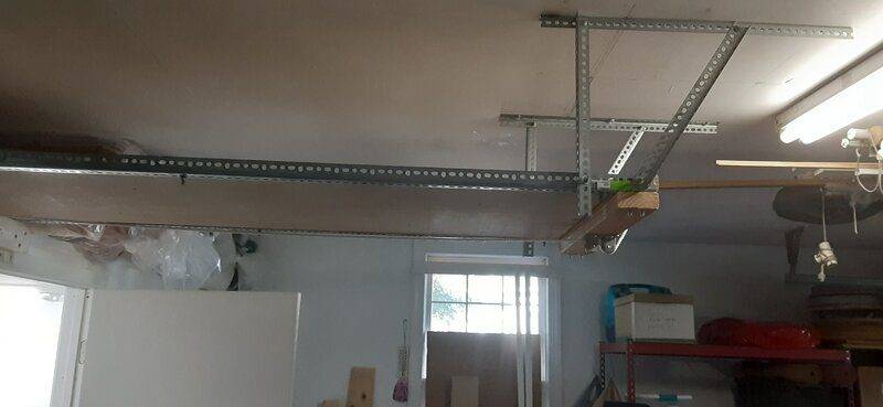

Photo of a slotted angle bracket bolted to a wooden board, with a red wireframe box drawn over the board and labeled Drawer Support Extension, One on each side.
This is the support for the drawer extension. the other end(s) would be supported by similar Slotted Angle, secured to the garage's ceiling beams, similar to how the garage door system is supported.
These, will be help in place using shelf-like brackets, outlined by the red lines; again one on each side.
Between these two Angle's will be a 5' 10" Long x 26" Wide x 1/4" Thick piece of ply. I will add three planks of wood that will attach under and between the Angles for additional support. (not shown)

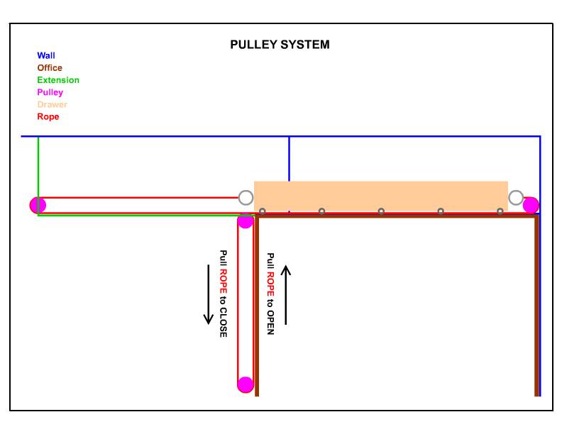

Diagram titled PULLEY SYSTEM showing a drawer in an office section, with a rope routed over pulleys to pull it open and closed; a legend lists Wall, Office, Extension, Pulley, Drawer and Rope in colour.
This was my original idea for moving the drawer

If you are determined to open and close using a motor, I suggest taking a long hard look at a standard garage door opener. Garage door openers have everything you need for motion control built in. A gear reduction to an appropriate speed, adjustable limit stops, and overload shutdown. If you do not have room to use the entire door opener, you can use the power head to drive a pulley system as shown in your sketch in Post #4. If the necessary travel distance is farther than the door opener allows, change to a larger sprocket or pulley. And the cost is less than anything you design by the time you get the speed right, limit stops working properly, and an overload shutdown calibrated and working.

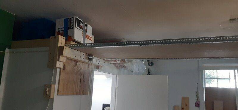

Okay, so after several weeks of tinkering around, I'm finally done.
My initial thought of needing a motor to open and closed the drawer were a bit exaggerated, okay maybe over exaggerated, but I've learned things I didn't know before and that's always a plus.
The wife can open and closed the drawer using the pulley system, without too much effort, so that settled the motor issue.
Thank you all for your advise in the matter.
Peace,
Element13
