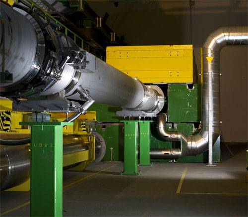

I'm unable to quickly find any mention of how thermal expansion is handled for the 27 km vacuum tube. I imagine tight temperature control in the tunnel is used, though a loss of thermal control allowing ~3degK change leads to a meter of length change in steel.

It looks like there might be a bellows in your picture - above the leftmost green post.
You mean MFB's LHC picture?
Yes, in post #14,
Thermal expansion is a major issue. Not so much for the outermost tube, where you can control the temperature, but for the beam pipe with the magnets. You have to install them at room temperature, and then cool them to 2 K. There are many bellows to handle the shrinking magnets.
The beam dump has bellows every 12 meters (no magnets in that region), the image in post 4 shows one of them. Vacuum design report, page 13.

Thanks, yes, the bellows is visible. The LHC then has many parts moving with respect to each other in expansion: inner tube with crogenics, outer tube, green supports. Tube travel (in the mm range per 12 m section but it's there with delta T) still has to occur with respect to either the tube wrt supports, or the supports wrt to the floor. The vacuum report you supplied references the "supports" for the tube, both fixed and "mobile", without elaboration as to what mobile means. In the post 14 photo I can't pick up any indication of a travel mechanism (e.g bearings) between tube and green support. Does the base of a "mobile" support travel (seems unlikely)? Or does a support simply flex, wrt the nearest fixed support?
Figure 12.10 looks like the beam pipe could move on some supports (along the beam pipe direction).
The idea is to minimize the motion of the shells, which are roughly at room temperature, and let the cold internals adjust via an expansion bellows. There are constraints which make this an idealization rather than a strict rule, but that's the idea.
