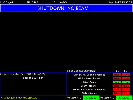

Recovery from technical stop is still ongoing. The RF system (radio frequency cavities to accelerate the beam) cannot handle the 2556 bunches we had before, the problem is under investigation. With 2317 bunches it works, for now the LHC is running with this lower number of bunches. Still enough to collect a lot of collisions. ATLAS and CMS reached 7/fb, LHCb collected 0.24/fb.I made a thread about results from EPS.
Edit on Wednesday: Finally back at 2556 bunches.

ATLAS and CMS reached 20/fb. We have gained 4.5/fb since the previous post 21 days ago, or 1.5/fb per week, even below the pessimistic estimate from above. You can see this clearly in https://lpc.web.cern.ch/lumiplots_2017_pp.htm as well.
A problem appeared in a region called 16L2, which lead to the dump of many fills, often before collisions started. Although the cause is not well understood, the process is always the same: Some beam particles are lost in this region, and a few milliseconds (tens of revolutions) later many more particles are lost roughly at the opposite side of the ring - more than acceptable, this triggers a beam dump. This can happen from either beam 1 or beam 2, although they fly in separate beam pipes in 16L2.
The problem appeared early in the year already, but until August, the dump rate could be managed by adjusting the control magnets in this region a bit. With increasing beam currents, it got more problematic and the machine operators wanted to get rid of the problem. The losses look gas-induced. The gas can stick to parts called "beam screen", and get released during the run, the collision of the beam with gas particles leads to the observed losses. The usual approach is to heat this beam screen, then all the gas evaporates, and gets pumped out or sticks to even colder parts of the beam pipe where it stays.
That was done on August 10 - and then everything got worse. Now more than half of the fills were dumped due to 16L2, even at lower numbers of bunches. The smaller fraction of time in stable beams plus the reduced number of bunches lead to the slower accumulation of collision data in the last three weeks. The leading hypothesis is gas in other components of 16L2 that redistributed when heating the beam screen and other components, leading to even more gas there.
What to do?
  • The problem could be solved by heating up the whole sector and pumping it out properly. That would probably take 2-3 months, doing it now would mean most of the time planned for data-taking this year is gone. Unless data-taking becomes completely impossible this won't be done before the winter shutdown.
  • The machine operators see if there is a stable running condition that works for now. The last few runs with 1550 bunches were promising, at this rate the LHC would be limited to ~2/fb per week, but that is still a reasonable rate that would double the 2016 dataset by the end of the year.
  • Gaps between bunches can reduce losses, e. g. "8 bunches in a row, then 4 slots free, then 8 bunches in a row, then 4 slots free, ...". This might be tested. It would also mean the number of bunches has to be reduced compared to the initial plan, but if it reduces the number of dumps sufficiently it can be worth it.
  • There are some special runs planned/proposed for 2018, some at lower energies and some with a very low collision rate, for something like 1 week in total. They might be shifted to 2017 as they won't be affected by the 16L2 issue as much as the regular operation at high energy and collision rate.
  • The machine operators discuss what else can be done.
