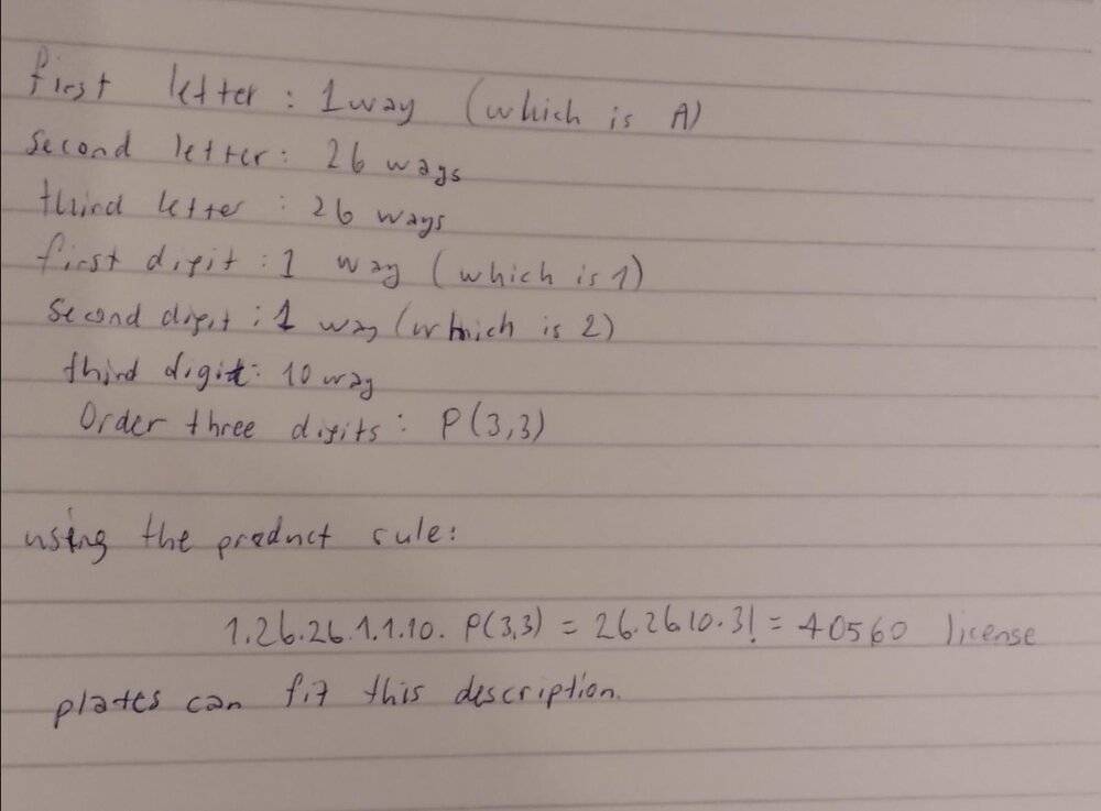

haruspex said:
You are double counting some of the numerics. E.g. you are counting 112 as an example of x12 and as an example of 1x2.
So the answer became 36.504
haruspex said:
Yes.
I guess there is no a similar application at letters order.
Quite so, that was easier. Had you only been told there was at least one A then, depending on your approach, there would have been a risk of double counting.
(But in that specific case the easy way is 263-253.)
