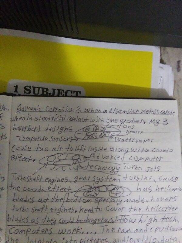

I am trying to make a hoverboard at home. Here's tge design I need to get specially made helicopter blades where can I get that and would it be possible to make blades big enough and small engh to fit underneath a board without sticking out and being able to keep the board compact I would also need help getting a specially designed board to fit stuff in it. Could I cover the he'll blades so won't get hurt somehow? I also will use the coanda effect inside the board would that work
I want the board to use air to lift itself of with the coanda effect which is when air sticks at the bottom of somthing and proppels it upwards along with specially designed heliblades.l and I want somthing to cover tge blades and make it safe and I want it be compact like back invite future or as close as possible

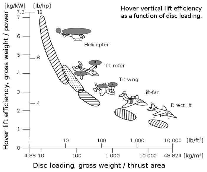

If you do the calculations, you will quickly find that you need the power of a jet engine to lift a person and flying machine. The power required, and necessary fuel consumption, is why jet packs have such short flight duration. Here's a good link to get started: https://en.wikipedia.org/wiki/Jet_pack.
A nice plot showing the relationship between rotor (fan) diameter and power required:
That figure is from a discussion at: https://helicopterforum.verticalreference.com/topic/20434-rotor-diameter-vs-power-required/. The Coanda effect will help, but not as much as you think: https://en.wikipedia.org/wiki/Coandă_effect.

No I don't I'm still figuring out how to make this hoverboard and waiting for this recession to be over. I still need help figuring out how I would get specially made parts such as the heli blades and how to calculate how big they need to be exetera. I am pretty confident that heli blades combined with the coanda effect should allow it to hover a person also I don't nkow what I would cover the blades with so it wouldn't be dangerous. Here's the closest to specs I got with 3 diffrent designs the idea is to trap air inside the hoverboard so the coanda effect can work inside the hoverboard and under the hovetboardi
Using a skirt on the Hoverboard would be the most efficient approach, IMO. You can look at existing personal hovercraft to see what engine power and blade designs they are using...
