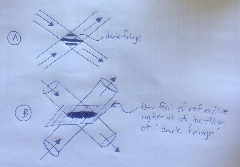

Hi all,
(See attached image file)
Two mutually coherent and collimated light beams intersect as shown, creating the stationary 'bright' and 'dark' fringes of fig.A. Suppose that, after the fringe pattern has formed, we insert a very thin (compared to the fringe-width) and (ideally) perfectly reflecting foil, as shown in fig.B. It appears as if we can "cut the light beams in two, across an impassable barrier" yet the light beams persist and freely propagate!
Is this possible??

Pelion said:
Is this possible??
No. Although the intensity of the wave falls to zero at that point the wave is still there. Introducing the barrier will block or reflect the wave.
Edit: What you have drawn in the second picture is just reflection.

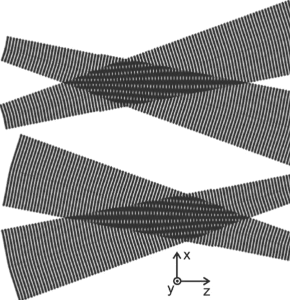

I also just realized the interference pattern in your drawing is not quite right. The fringes will appear both vertically and horizontally.

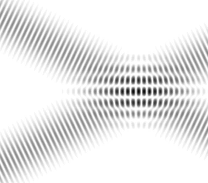

Pelion said:
looks much more promising for my case...although pics above are for slightly non-collimated (diverging) beams, the dark fringes are 'continuous' across the plane of the proposed reflective foil

Is what possible? You can certainly insert a thin reflective surface in the space where the two beams intersect, but beyond that I'm not sure what you're asking.

Well, it certainly is counter-intuitive and seems paradoxical that two freely propagating waves can be completely 'cut' by a 'wall' and persist as traveling waves! If this is the case, there may be interesting applications, and the same effect can be created for photons in the quantum-optical realm. The amplitude doesn't matter here, so: Don't you find it strange that we can have trillions of photons streaming along, on one side of the barrier, then they "go somewhere else and in reside some other state" (in the region of stationary fringes), so that an impassable barrier becomes 'invisible' to them, and they emerge and continue to stream along on the other side! Talk about a 'tunneling effect,' if this is true!

No photons will bass through the barrier because it is a BARRIER. Let's assume it is a good barrier with a high potential such that tunneling is out of the question. A poor barrier could be a partially reflective surface, which let's some light through anyway so no mystery there.
If you stick a reflective surface in the middle of the crossing beams, then the two light beams will just reflect off of the surface. If you put a nonreflective surface in the middle, then no light will be reflected. In either case, the light does not pass "through" the barrier.

I doubt you realize that the perpendicular component of the magnetic field ##\mathbf{H}_{\perp}## and the parallel component of the electric field ##\mathbf{E}_{||}## go to zero anyways at the surface of a perfectly reflective surface. The boundary conditions that must be satisfied at the surface with unit normal ##\mathbf{n}## are
$$\mathbf{n\cdot D}=\sigma$$
where ##\sigma## is the induced surface charge desnity
$$\mathbf{n\times H}=\mathbf{K}$$
where ##\mathbf{K}## is the induced surface current and
$$(\mathbf{B-B^{\prime}})\cdot\mathbf{n}=0$$
$$(\mathbf{E-E^{\prime}})\times\mathbf{n}=0$$
at the surface.
Now that you have the needed boundary conditions, do the math, solve the wave equation, and see what actually happens. If you are unable or unwilling to solve the problem, then you will have to just take the our word on what happens here.

Perhaps more importantly, your drawing of the interference pattern of the light isn't even correct. NFuller already posted the correct picture, showing that there is a number of nodes, not a single plane-shaped node. This is true regardless of whether the nodes are the light or the dark areas as can clearly be seen.

...hmmm, you may have things in reverse, but I am not sure yet...you may be showing us a 'negative'...in other words, the dark areas are the bright fringes...in that case, the case continues
Note that none of the nodes pass through the middle of the volume of intersection between the two beams. You'd have to offset the barrier vertically, destroying the symmetry of your original drawing.
I'm fairly certain the dark regions in your linked picture are not nodes. You don't usually color the areas of constructive interference the same color as the background.
