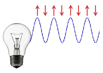

Perhaps a picture would be better. Attached I have a picture of a light bulb emitting some light and I have some red arrows that, I think, represent the orientation of the electric field. Would you say this is accurate description? Of course, I'm depicting one plane of waves. Is it safe to assume that there are move light waves are propagating at any and all planes? - rotating the blue wave 360 degrees into the page.

Regarding the picture, if the source of light were a laser that would be reasonable. Incandescent bulbs produce incoherent waves so it wouldn't be nice and neat as drawn.
