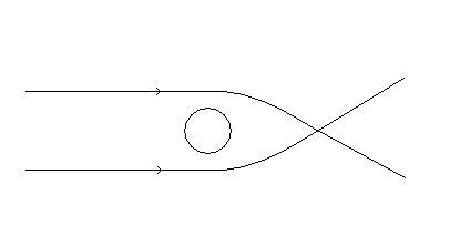

What do you think of this? My guess (with my limited knowledge) is this is what will happen.
