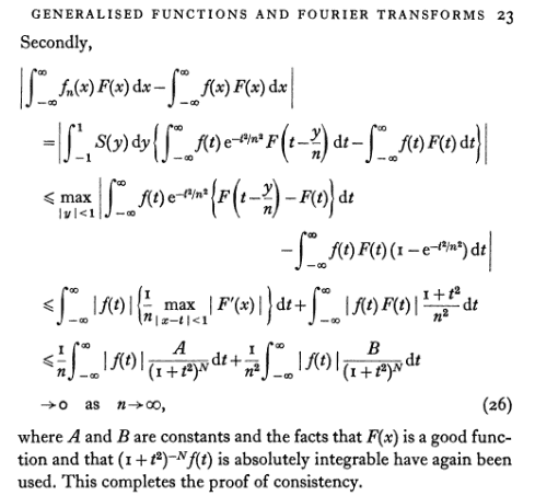

In the third picture.
3rd line and 4th line. i don't understand why 1-e^(-t^2/n^2) become (1+t^2)/n^2

rar0308 said:
see the pictures
View attachment 66493View attachment 66494View attachment 66492
one.
It's an inequality. ##1-e^{-t^2/n^2}## doesn't "become" ##\frac{1+t^2}{n^2}##; they're saying that ##1-e^{-t^2/n^2}\leq\frac{1+t^2}{n^2}##, which is provable using elementary calculus (hint: what is the global min of ##g(t)=\frac{1+t^2}{n^2}+e^{-t^2/n^2}-1##?).
