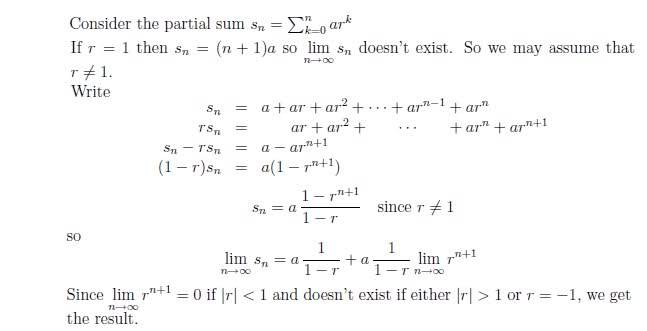

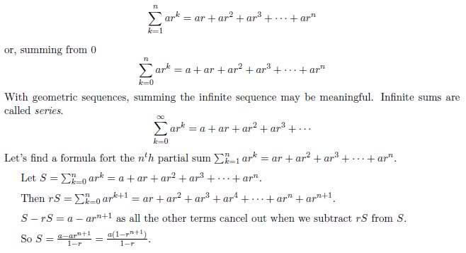

OK, here's what I've got for the definition of the cauchy criterion. But i don't know how to apply it to these problems. We've done literally 5 examples using cauchy, and i don't understand any of them...
Someone else gave me this but it's all greek to me

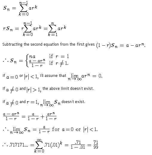

Yepp, totally lost. Do i do it like these examples?
Your solution of II (a) should look like those examples.
