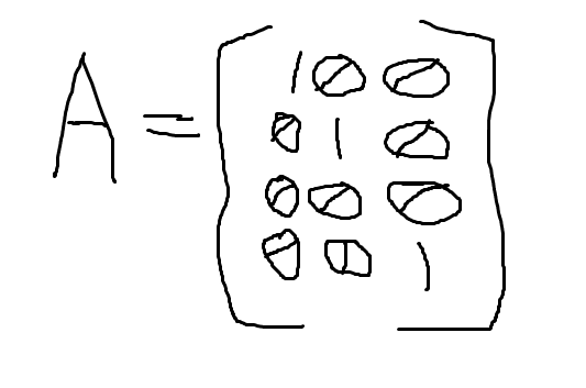

Show if S = {v1,v2,v3} is independent or dependent . . .
(0,0,0,0) = k1(a,b,c,d) + k2(e,f,g,h) + k3(i,j,k,l) where {a,b,c,d,e,f,g,h,i,j,k,l [itex]\in[/itex] ℝ}
im trying to tell if i can say that this set of 3 vectors in R4 is dependent right away, just because there are less vectors than the number of dimensions. . . i looked in the book and the opposite is true -- if you have 4 vectors in R3, then the set is linearly dependent . . .
thanks
otherwise, do i just row reduce?
I row reduced and got:

Are the vectors in the problem <a, b, c, d> etc. or are there any constants involved? The matrix you show in another post makes me think there are some numbers.
If you have 4 vectors in R3, the set will always be linearly dependent, but when there are fewer vectors than the dimension of the space they're in, you can't say anything without doing some investigation.
If you have 3 vectors in R4, the vectors might be linearly independent or linearly dependent - it depends on the vectors.
For example, if the set is { <1, 0, 0, 0>, <4, 0, 0, 0>, <0, 1, 0, 0> }, this set of vectors is clearly linearly dependent - the 2nd vector is a scalar multiple of the first.
If the set is { <1, 0, 0, 0>, <0, 1, 0, 0>, <1, 1, 0, 0> }, this set of vectors is also linearly dependent, but it's not so obvious, as no one vector is a multiple of any other. However, the 3rd vector is the sum of the other two.
If the set is { <1, 0, 0, 0>, <0, 1, 0, 0>, <0, 0, 2, 0> }, it can be shown that this set of vectors is linearly independent. Your textbook probably shows some examples of testing sets of vectors for linearly independence/dependence.
the problem has specific numbers in place of all of those letters that i used for an example.
my problem is of the type:
i row reduced, and got the final matrix posted (poorly) above . . .
my main thing is trying to learn the concepts of how to solve these problems, and what everything means -- computationally i am quite comfortable of how to set up a problem and solve it, but i need to make sure that I am setting things up the right way so that i can show what i am asked to show. . .

The computations are the easy part. Understanding why you're doing what you're doing is harder, since you can't operate on autopilot.
Keep in mind that your matrix represented the vector equation you had in post #1, and you were solving for the constants k1, k2, and k3. The reduced matrix you showed tells you the value of those constants.
There's a little missing though. Your vector equation can be represented as an augmented matrix with a column of zeroes on the right - like this: [A|0]. After doing row reduction, you got a different matrix, so the augmented matrix would look like this: [B|0], with B being a matrix with a few 1's as leading entries.
What that augmented matrix is telling you is that k1 = k2 = k3 = 0, which should tell you something about the vectors and whether they're linearly independent.
