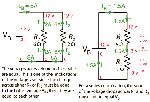

When you parallel two 50 Ω resistors, the equivalent resistance will be 25 Ω. When you series two 50 Ω resistors, the equivalent resistance will be 100 Ω. So the more resistors you parallel, the more current will flow; hence why the smoke.
See the difference in the sourced current in these two examples:
You need to measure the current this device takes at 4.5 volts. Set your power supply to 4.5 volts.
Then put a current meter (ammeter) in series with the supply.
Once you know this, you can calculate the size of resistor you should place in series with the lights to run them off 12 volts. Actually, assume the car battery voltage is 14 volts.
The resistor will have (14 - 4.5) volts across it (or 9.5) and (the current you measured), passing through it.
So, suppose you measured 400 mA current. This is 0.4 amps.
The resistor size (using Ohm's Law) would be R = (9.5 volts divided by 0.4 amps), or 23.75 ohms.
Then you need to work out how much power it is going to dissipate.
Power = Voltage times current
Power = 9.5 volts times 0.4 amps, or 3.8 watts. So, you could buy an 27 ohm, 5 watt resistor.
Notice that this depends on your current measurement, so you need to substitute your figure for the 0.4 amp figure I guessed above.
