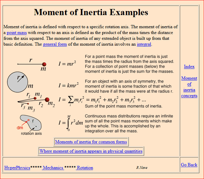

the rotor arms moment of inertia increases when the magnets are forced together and drop when de loading occurs.
moment of inertia is a property of a shape, set by where on that shape its mass is located. That's what changes when your magnets shuttle back and forth inside the tubes.
http://hyperphysics.phy-astr.gsu.edu/hbase/mi.html

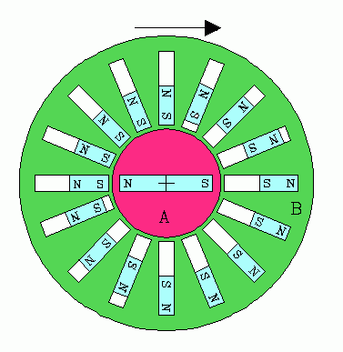

What I am observing is that as the rotor arms accelerate and decelerate every quarter turn there is no counter rotation of the body.
I'm not sure I would expect the rotor accelerate and decelerate if the rotor magnets are free to move. Nor would I necessarily expect the body to counter rotate.

Is the rotor is rotating fast enough for the magnets to slide outwards on their own? If so how are you observing or measuring the acceleration/deceleration of the rotor?

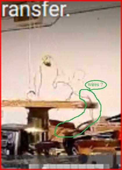

Video on youtube, title the same as here: Loading / Rapid de loading of DC motor. Any feedback welcome.
Regards, Roger.
EDIT youtube URL removed, read on...i see a structure suspended from a string that has a really low torsional natural frequency , looks to me like ~14 second period
and that structure clearly wobbling at the ~4 hz vane frequency, attenuated as one expects of a low pass system excited almost two decades above its ω0
suggesting the torque due to magnets pushing against one another isn't quite canceled by the motor torque
that's my take.
An ammeter on that DC motor would be interesting,
old jimEDIT now it's gone ? see my signature...

It unwraps the string torsion, appears to overshoot
but video ends before it completes a cycle so can't tell if it's centered about equilibrium
there's three inertias returning to zero
motor internals, vanes , and rest of structure
we don't know how the sum is apportioned between them at instant of switchoff.

There is no unwrapping of string torsion, the body is in fact in front of rest position so acting against slight restoring force when power is switched off.
Three inertias returning to zero -separate motor and vanes momentum,( ie moving when body is not ), zero after collision - Body momentum after transfer collision as seen. zero only after transfer of energy to exterior interactions.
Body moves almost one rotation after power is switched off, in the direction of rotor arms and body is not counter rotating at that time.

When it's switched off it makes one whole turn in direction of vane rotation.
chazemz said:
as the rotor arms accelerate and so acquire momentum. The body should acquire the same amount of momentum.
At switch-on time it makes a half rotation then oscillates about rest position.
At switch-off time it makes a full rotation.
Playback at 1/4 speed shows vanes rebound at switchoff time , i think that reversal explains the difference in switch-on and switch-off motion.

This is a conservation of angular momentum experiment. That will be more obvious if you hang it from a tape, then increase the mass inertia of the rotor and reduce the mass inertia of the body, so as to make them similar.
As usual, the sliding magnets are only there to add je ne sais quois and some complexity magic to confuse the situation and so disguise the prestidigitation.

Thank you for your kind words.The sliding magnets are there for a reason. The clue is in the title of this thread.
