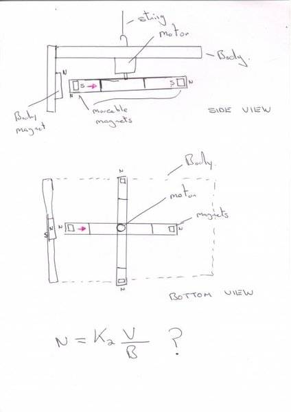

HiI have a device comprising a dc motor connected to a body and connected to the motor are four rotor arms. As the rotor arms are rotated they pass a point on the body that applies load to the motor then rapidly de loads the motor. So that every quarter turn the motor is loaded and then de loaded. The device is suspended by a length of string so that there is no contact with the ground. What I am observing is that as the rotor arms accelerate and decelerate every quarter turn there is no counter rotation of the body. Am I to understand that in the de loading process that the flux density in the motor decreases rapidly so that the speed must increase at the expense of torque. This acceleration without ( or with very little ) torque may explain the lack of torque reaction observed. Hopefully someone can help explain the process better?.

Hi thank you for your reply. Hope the sketch helps. As you can see the load is produced by the magnets being forced together and when the poles are facing the magnet in the tube fires down the tube de loading the motor. The voltage is fixed so the rotor arms are moving very slowly when the tube magnet fires down the tube so the change in angular momentum will be minimal. The repelling magnet fields in the loading process explain the absence of torque reaction for half of the interaction but the lack of it in the acceleration phase has up to now puzzled me. Hopefully you can explain this to me as I am not an expert on dc motors Since the body is not moving in the opposite direction you can turn the motor off as the rotor arms begin to accelerate and the following rotor arm magnet will collide with the body magnet imparting its momentum onto the body causing the body to move in the direction of the rotor arms. I welcome any further questions you may have.
  • Hand-drawn sketch of a motor with a rotating arm of movable magnets, suspended by a string, beside a body magnet; side view and bottom view labelled, with the equation n = K2 V/B and a question mark below.

This is certainly an intriguing device. It has all the ingredients found in designs for perpetual motion machines, and a motor.
What returns the sliding magnets to the outer ends of their tubes after passing that repulsive body magnet?
What is the purpose of the machine?
Centrifugal action returns the magnets to the outer edge ( they are fleeing from the center ) as the rotor arms accelerate after each interaction and the purpose of the machine is to convert electrical energy into momentum or in this case angular momentum. Just so we are clear this is no perpetual motion device, power must be supplied to the motor to enable the rotor arms to rotate.

Will body oscillate as a magnet in a vane approaches then recedes from the magnet on the body ?
Hi I take it both of these thought experiments are in relation to the device? To answer the first ,the momentum is transferred to the body that must rotate through its environment and so interact with it. The time that it is able to do so is dependent upon the density of this environment. So to put a time scale on things if in deep space a long time , if through treacle not so long. On the subject of forever it would be better to look at the formula supplied with the sketch. If flux goes to zero then speed must be infinity. Assuming there is a rate of acceleration it is reasonable to conclude that it will take an infinite amount of time for the motor to accelerate to infinity or in other words forever. The second is the word in and not on. If the magnet were ON then as it passes the body magnet the repelling magnetic interaction will push against the body magnet pushing the body backwards whilst the rotor arms will also get a push . I would have thought that the body would step backwards as the rotor arms accelerate With the magnet IN this interaction can not take place as the energy build up in the collision phase is released by the momentum of the magnet traveling down the tube and the body does not get its magnetic push backwards. On the motor I am using a ELVI code 102.567/FCE type. A person has asked for specs on this motor on the internet so when someone gives an answer I can supply this to you. If you feel the answers are vague in any way please contact and I will attempt to be more clear .
Where i was heading is
there's two pieces
the arm-body magnets
and the motor
if the motor tries to maintain constant speed which with constant applied voltage it will,
will it apply to the body torque that's equal and opposite to that of the first repelling then attracting magnets as vanes sweep past ?
Hi Jim sorry I misread the questions. My sketch may be misleading, The body magnet has the north pole facing inward towards the end of the rotor arms. The magnets in the tubes are all north pole facing outward so that as the tube magnets attempt to travel across the body magnet they face each other and the body magnets are propelled down the tubes so they are no longer influenced by the body magnet. The motor is now in a no load situation and is free to accelerate. The following magnet which is at the end of the tube rotates into the body magnets repelling magnetic field and as the distance between them decreases the repelling magnetic fields build until the sudden release so there are no attracting magnets as the vanes sweep past. Apologies for any confusion caused. On the body torque in the repelling phase , the body magnet wants to push away from the oncoming rotor arm so it pushes back against the torque reaction locking the body in place.If a tube magnet sticks in the tube and misses a repelling interaction, the rotor arms will accelerate and the body will start to counter rotate when the tube magnet becomes unstuck the system goes back to its acceleration and deceleration mode with no counter rotation of the body. You are right that there are two systems here and I am reasonably certain it is what happens in the motor that is the key to this.

Conservation of angular momentum would suggest that the body should counter rotate when the motor drives the rotor arms. If the body remained static when the rotors were driven, then you will have invented a helicopter that does not need a tail rotor.
I cannot see why this configuration is being contemplated, or why it might be built.
+1
My guess is he hold the body stationary until the motor is up to speed then releases it. If he does than then the body only spins when released because the rotor experiences air resistance rather than because of conservation of angular momentum.
Averaged over long periods (say one revolution) there is no change in the momentum of the rotor. So over the same time period you wouldn't expect any change in the angular momentum of the body (due to conservation of angular momentum).
Over shorter periods you might expect to see the body oscillate back and forth. However if the body has much higher mass than the rotor (where is the battery?) then the motion of the body might be quite small or barely detectable. (eg If I run laps around my garden there is no obvious counter rotation of the planet).
Edit: The motor is probably operating in a constant speed mode so it will be trying to smooth out any changes in velocity caused by the magnets. So are you sure the rotor really is accelerating/decelerating?
I suspect that the force that pushes the magnet towards the rotor centre and so slows down the rotation during that process, also speeds up the rotor because the radius of the mass is being reduced. Once the arm has passed the fixed magnet the process is reversed.

chazemz said:
The end result is that the body rotates in the same direction as the rotors were moving
What happens if you reverse the direction the rotor is moving?

i've been looking for the missing link in observations and thought process.
red part - maybe braking action of the motor more than the magnets ? Trying to conserve Angular Momentum ...
That experiment, turning off the motor seems significant.
Is the motor geared ? Its armature may have substantial MOI of its own. And we don't know if its angular momentum adds to or opposes that of rotor vanes.
Another experiment to investigate that - increase MOI of rotor by placing two magnets in each vane. That'll change ratio of MOI's rotor vanes to motor armature.
