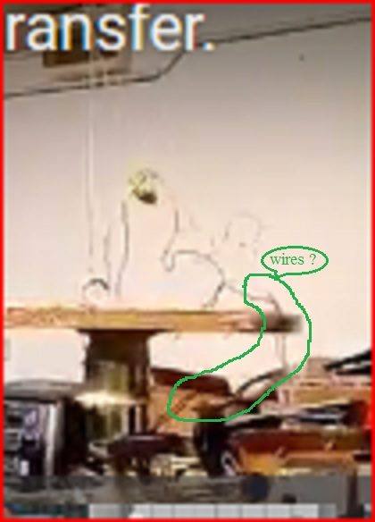

The wires?
When power is applied it swings through about 3/4 turn , looks like it's hunting about an equilibrium position .
I estimated period at around fourteen seconds, 1/14 hz.

CWatters said:
It's not clear to me why the body doesn't spin in the opposite direction to the rotor all the time the rotor is turning (eg due to air resistance). There must be something preventing it. That something can be storing energy that causes the thing to rotate in the same direction as the rotor when it's switched off.
Edit: Even if that's not the cause its potential to be the cause needs to be eliminated. You can mount the body on two ball races and use them to carry the current from the power supply to the motor.

jim hardy said:
The wires?

The wires exert a restoring force in either direction.
I have no idea what you are describing with the clock analogy. Please clarify.
angular displacement from rest in units of hour markings on a clock face rather than degrees
