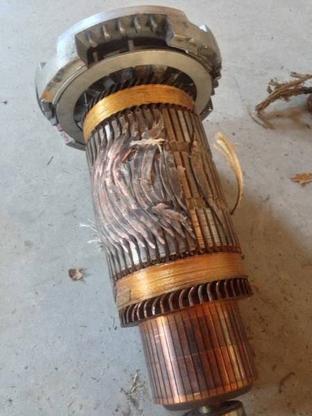

A series motor will accelerate until torque = friction and windage losses plus load. If unloaded it is likely to overspeed and self destruct. That's why you never connect one to its load by a belt.
here's a recent PF thread that's similar.
https://www.physicsforums.com/threa...c-motor-increase-when-flux-is-reduced.804006/
this image is posted there, of a series electric vehicle motor. It was in neutral and the accelerator got floored.
http://electricmr2ev.blogspot.com/2013/01/warp9-disaster-overspeed-motor.html
This occurred when the car was in neutral while in the garage, by mistake I carpet got stuck on the accelerator and the motor spun real fast probably 6K + at least it took about 2 seconds when the motor stopped
Centrifugal force throws the armature windings out into the air gap where they get chewed up.

Speed of course won't make it to infinity the motor will fly apart as in that photo.That's why you noticed as a kid that Mom's vacuum cleaner motor speeds up when you put your hand over the suction port.
And it's why the vacuum cleaner motor has its impeller connected right to the shaft.
Old Chrysler automobile starters, which are series machines, had a small shunt field to prevent their self-destruction should the Bendix gear fail to engage.
