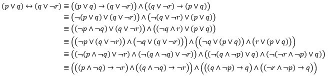

And I just don't know what to do from here... Any help will be greatly appreciated!
I think you should use the distributive law on expressions like:
##(\lnot p \land \lnot q) \lor (q \lor \lnot r)##
to get:
## (\lnot p \lor ( q \lor \lnot r) ) \ \land \ (\lnot q \lor (q \lor \lnot r) )##
Then, in those propositions that involve only "##\lor##"'s, you can change the pattern ##A \lor B \lor C## to ## \lnot( \lnot A \land \lnot B) \lor C## and then get rid of the last ##\lor## by changing it to ##(\lnot A \land \lnot B) \implies C##.

Hi, thanks for taking the time to respond. Does this look correct to you?
Also, how would I prove that the original expression and the one I derived are equivalent using logical equivalencies? (I.e., I think I have to convert everything in the original and derived expressions to T's and F's (True's and False's), and they both have to reduce to the same.)
Again, thanks so much for your help!
You are doing the double negations like changing ##\lnot (\lnot p) ## to ##p## without showing it as a step. Some instructors may permit that.
The expression ##\lnot q \lor (q \lor \lnot r)## could be simplifed to ## ( \lnot q \lor q) \lor \lnot r## and then to ## T \lor \lnot r## and then to ##T##.
The rules you are using change expressions to logically equivalent expressions, so your steps are guaranteed to result in a logical equivalence.
Of course, you can check your work by using a truth table.
If you had a rule that was not a logical equivalence such as ##p \lor q \lor r \implies p ## and you changed the expression ##(p \lor q \lor r)## to ##(p)## then you could not claim that such a step produced a new expression that was logically equivalent to the old expression. However, all the rules you listed use the relation ##\equiv##.
