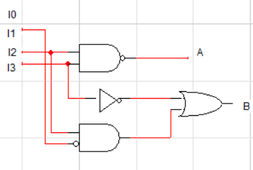

Design a 4-2 priority encoder with active low and enable.
Here's my work , but I don't know how to connect the enable input.
Any help would be greatly appreciated !
Truth table with columns EN, I3, I2, I1, I0, A and B, showing enable and four inputs with X don't-care entries and two encoded outputs A and B.
Karnaugh map with input labels I1 I0 across the top and I3 I2 down the side, showing rows of 1s, 1s, 0 0 X 0, and 1s, with an X in the third row.
##A = \overline{I2}+\overline{I3}##
Karnaugh map with 4 columns and 4 rows, labelled I1 I0 across the top and I3 I2 down the side; rows read 1 1 1 1, 1 1 1 1, 1 1 X X, and 0 0 0 0.
##B=\overline{I3}+I2\overline{I1}##
Logic circuit schematic with inputs I0 to I3: a NAND gate with inputs I2 and I1 drives output A, an inverter on I3 and a NAND gate with inverted input feed an OR gate producing output B.
  • Logic circuit schematic with inputs I0 to I3 on the left: a NAND gate with inverted output labelled A, an inverter on I3 feeding an OR gate, and a NAND gate with inverted output feeding the OR gate, whose output is labelled B.
Active low what? Active low inputs?
And for an asynchronous circuit, what would an enable do? One function might be to clock the new outputs into output latches, but you would need to expand on the problem statement to be sure...
https://en.wikipedia.org/wiki/Priority_encoder
And can you expand on how enable inputs have been used so far in the circuits you've been studying? What are they usually used for? How are they often implemented?
BTW, if you are to use active low inputs, does that mean that the enable input should be active low as well? Right now your truth table has the enable input active high...
It allows a signal to pass when the control signal is high.
Use 2-input AND gate , one input as the enable and the other one as the control signal.
Well, that can be one use of an asynchronouse enable signal. I guess it's up to what you are covering in class right now. At least for me, and enable signal is used to keep the outputs of a circuit block from transitioning when they should not be changing. For example, depending on the delays in that priority encoder, when the inputs change, the output may not change directly to their new value. They may be scrambled temporarily as the input signals change and the delays through different parts of the circuit present strange code combinations to the later gates. So an enable signal could be used to hold the outputs at their current value until the input circuit is stabilized, and then the enable would gate the new values through to the outputs. You can use transparent latches for such a function, for example.
I'm definitely confused by the truth table saying that the outputs are don't cares when the enable signal is low, and then the outputs assume their correct values when the enable goes high. It would make more sense to me to say that the outputs held their previous values when the enable is low, and then assume the new output values based on the new inputs when the enable input goes high. That's where the output transparent latch structures would come in. Maybe ask your TA what is wanted for the enable function?
BTW, it looks like your truth table is missing the line where all inputs are = 1. What is the traditional output of a priority encoder with active low inputs when all inputs are high?

Fatima Hasan said:
The output = XX.
But you don't have a line where EN=1 and IN=1111...
berkeman said:
I'd definitely confused by the truth table saying that the outputs are don't cares when the enable signal is low, and then the outputs assume their correct values when the enable goes high.
As I know that if the first row is all 1? We don’t put it in the design. And we don't put the enable with the priority encoder. That's why I don't know how to connect the enable when I design the priority encoder.And I am not sure if the “enable” is high or low?
We just use 4 inputs and 2 outputs and design.
