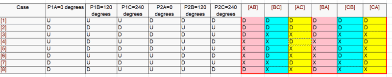

I don't know what you're talking about. The table @DrChinese gave covers all possible combinations of results. No combinations are ignored. The case where all 3 filters are passed and the case where all 3 filters fail is included in the table.
It doesn't matter what other structure there is "underneath" that produces the results. The point is that no possible table of predetermined results can match the QM prediction.
Furthermore, this is true whether we ignore the "pass all 3" and "fail all 3" possibilities or not. Either way no possible table of results can match the QM prediction.
I think you have not grasped the actual argument @DrChinese has been describing.
I can see where the average of 0.333 comes from, but it doesn't come from the average of the entire possibility space. While cases [1] and [8] are represented in the table, when it comes to calculating the average, they are ignored (which is what I mean when I say discounted). The reason given for this is because we don't know how often they occur.
Instead, the average for each row is taken, except for cases [1] and [8].
But, when I was asking about the case where we consider each column:
you immediately saw that this didn't treat the choice of filters as statistically independent of the particle pairs and therefore implied Superdeterminism. I didn't see it myself initially, but after thinking about, it I think I understand how you arrived at that conclusion.
That prompted me to wonder why taking the average of an individual row wasn't the same principle, just applied to particle pairs.
I was thinking that, for statistically independent events, we should consider the possibility space as a whole, as in this representation - where there are 24 possible outcomes:
This got me wondering, if we don't know how often cases [1] and [8] occur, it might be possible that they occur much less frequently than the other cases. It might be the case that in a given statistical sample they don't occur at all, while in other statistical samples they do occur.
If that were the case, the space of possible outcomes would still be 24 but the minimum number of matches we would expect to see would be 6/24 = 0.25. That is arrived at when we consider the other cases, which occur more frequently.
I was thinking that when we factor in cases [1] and [8] we would expect ≥0.25 matches.
My thinking is that, if cases [1] * [8] ("pass all 3" and "fail all 3") occur much less frequently that the other cases i.e. there is not an equal chance of them occurring, then they would remain in the space of possibilities but (borrowing DrC's words) "you never get a rate less than" 0.25).
I can see where the average of 0.333 comes from. My questions might be more to do with the application and interpretation of the statistics in general.

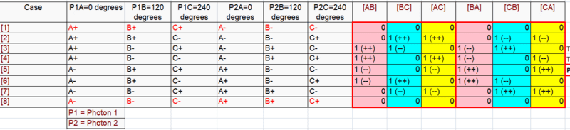

Cheers for this clarification. I was toying with the idea of weighting, but didn't have time to work through permutations.
I misinterpreted what you said in the explanation on your website, when you said about cases [1] and [8] that we don't know how often they occur which gave rise to the line of thinking of the past few posts.
Thinking through it further, obviously the ratio of matches to mismatches (without cases [1] & [8]) is 1:2 and given there must be some outcome of each trial, if cases [1] & [8] never occur the ratio of matches to mismatches for the statistical sample will have to be 1:2 (minimum number of matches being 1/3).Presumably it's not possible that instead of cases [1] & [8] being the case:
Photon 1: A+B+C+
Photon 2: A+B+C+
It was
Photon 1: A+B+C+
Photon 2: A-B-C-
Presumably there's either some experiment which has ruled this out, or it would it make any difference?
I've tried working it out on a spreadsheet, but as you may understand, I'm slow to trust my own analysis when it comes to statistics.
Photon 1: A+B+C+
Photon 2: A+B+C+
It was
Photon 1: A+B+C+
Photon 2: A-B-C-
There is no "Photon 2" in the scenario @DrChinese described.

Ah, that would explain a lot. 🤦‍♂️
I was thinking in terms of pairs of photons being sent to separate detectors . I thought there was an assumption that each photon has the same properties.
  • #43
In the scenario @DrChinese described, a local hidden variable model is being tested. In that model, each individual photon has pre-determined values for all three measurements, A, B, and C. The model is tested by making measurements on a large number of identically prepared photons. But in each individual measurement, only one photon is measured.

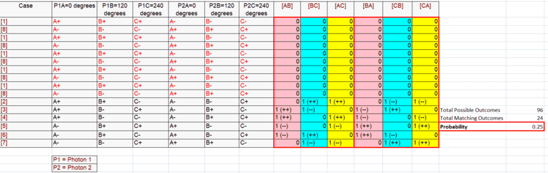

Would that be the case even if the photons were always identical except in cases [1] & [8]?
  • #51
What does this even mean?

PeterDonis said:
The table of possible values would be different, since there are two photons, not one. There would be 64 possible cases, not 8.
Apparently you didn't grasp what this means. The table is not QM; it is a proposed local hidden variable model in which each photon carries with it a set of predetermined results for all three of the possible measurements, A, B, and C. The 8 rows in the table for the one-photon case are the 8 possible sets of predetermined results. For two photons, there are 64 possible sets of predetermined results (8 for each photon, so 8 x 8 = 64 total).

I know it's a proposed local HV model, but to test it in the lab pairs of photons are required, no?
If both photons always have the same HVs there will only be 8 cases, not 64.
I was wondering if those two "special" cases - where both photons have the "pass all 3 filters" HVs or the "do not pass all 3" HVs - could instead have one photon with the "pass all 3 filters" HVs while the other one would have the "do not pass all 3".
The hidden variables carry enough information to calculate the outcome for each of six (two sides, three possible measurements at each side) possible +/- measurements. That is, the hidden variables carry enough information to answer 64 questions of the form "If this photon arrives at detector X when it is set to angle Y will the result be Z?" where X is left or right, Y is one of the three angles and Z is plus or minus. Whether the hidden variables are the same at both sides (that is, the answer to any two questions that differ only in the choice of X will be the same) doesn't reduce the number of questions, it just changes how we've encoded the hidden variables that we use to calculate the answer.

Apologies, I misread what PD meant by that, I thought he meant 64 combinations of particle pairs, as opposed to possible outcomes.
I was ignoring the 3 combinations where the filter settings were the same - is that the case when it comes to Bell tests? Also with my confusion about both photons having the same HVs, I was ignoring the opposite filter pairings i.e. I was only looking at AB and not BA (because I thought it wouldn't make a difference to the probability).
I don't suppose you can see at a glance, where I've gone wrong with the table below?
It only has 48 possible outcomes (excluding combinations where both filters are the same e.g. AA). It also has a 50% match rate, so I must be doing something wrong 🤦‍♂️
Including the cases where both filters are the same would bring it down to 33.33% but it would have 62 possible outcomes, instead of 64.
