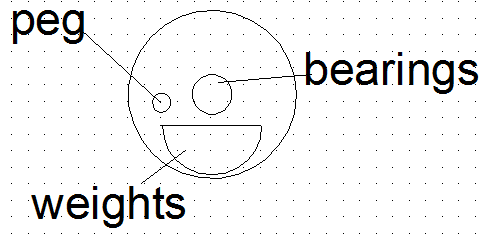

The "disc" is actually going to be a piece of PVC pipe cut to about 4" long. I'll insert a piece of acrylic cut to fit the ID of the pipe and then glue the acrylic inside the the back of the pipe. The other end of the pipe is open, and I will fill it with a piece of high density foam with a watch clasped on.
The bearings will attach (somehow??) to the acrylic, and then will fit onto the shaft of a stepper motor (I now think a stepper motor is probably best.) The arm can just attach to the motor shaft as well. I'm not sure how to fit it all on. I've attached a simple sketch of the disc that fits inside the PVC pipe. I would like the whole thing to swing as much as possible.
I'm open to suggestions.

Yes, that would also work, but I like the idea of the watch oscillating back and forth - it only requires the motor to make one full revolution in order to get a lot of watch movement. With a stepper motor there really wouldn't be much difficulty in programming the movement.
The main issue I'm having now is how I attach things to the shaft of the stepper motor. The shaft isn't very long, so I need some sort of coupling, right? Is there a specific kind of coupling to use with a perfectly round shaft vs. a "flat" shaft vs. a shaft that's flat on one side but round on the other? How do the bearings fit onto the shaft/coupling? Is it just friction (because the bearings and shaft/couplings are machined precisely enough to provide a very snug fit)? Or do I need some sort of hex coupling/bearing?

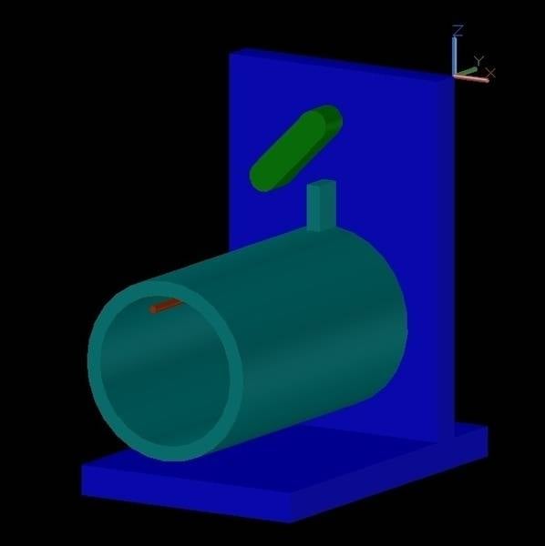

So I've been practicing autocad.. I'm getting better... and I drew up something I think would be simple and work well... You mentioned an arduino to control the motor, that could be implemented, or just a timer. The motor I have in mind for this would be a windshield wiper motor, though it's much bigger than necessary, it returns to the same point every time, which is nice.. a stepper motor would work too... I'm thinking you'd want perhaps a hall effect sensor for sensing when to give it another 'kick' located at some angle off vertical, so that if the sensor isn't getting a reading, it's time to nudge it again. The thing *I* like about this idea is that the motor doesn't have to keep moving for the pendulum to swing, reducing friction.
I left the front of the tube open, you can put weight in it if necessary, but it will need a little pivot point for the shaft and a retainer.. I don't think you need any bearings, using a small shaft 3-4mm... 3/16" will pivot plenty well enough.
How does it look? Motor mounts on the backside
