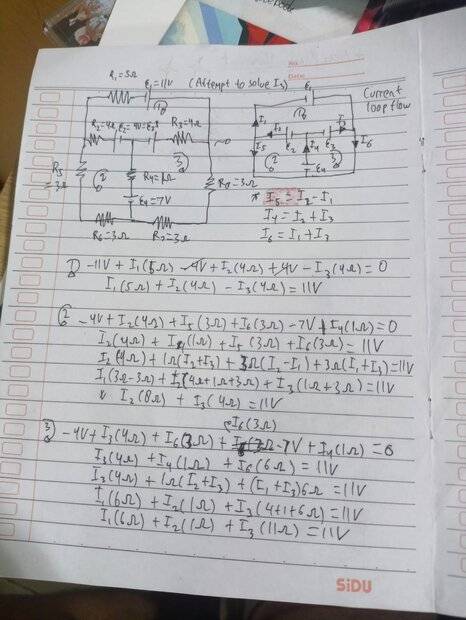

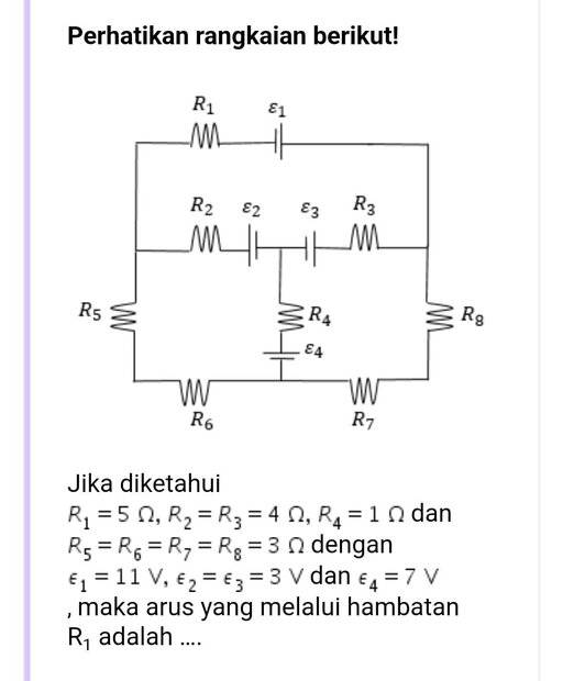

Find the value of current which is flowing through R1 and R8.
The First and Second Kirchoff Law for Electricity
Here's the problem. My teacher said I can determine whatever the loop direction is (Counterclockwise or Clockwise). My problem is with finding the exact value when given 3 equations. Can you help me?
Here's the given loop direction that I used:
Loop 1 (Above): Clockwise
Loop 2 (Left): Counterclockwise
Loop 3 (Right): Clockwise
(This question is in Indonesian, just take the clues from the given question. Please help me, I'm struggling to understand this 3 loop)

There. You may check the attempt that I have made. I'm just making sure that the loop equations are correct.
eleking16 said:
View attachment 357606There. You may check the attempt that I have made. I'm just making sure that the loop equations are correct.
Hello,
Do you have any doubt that you are incorrect in your workings? Please break up the images so we don't have to squint ( maybe that's just me...) at least one for the diagrams one for the math.

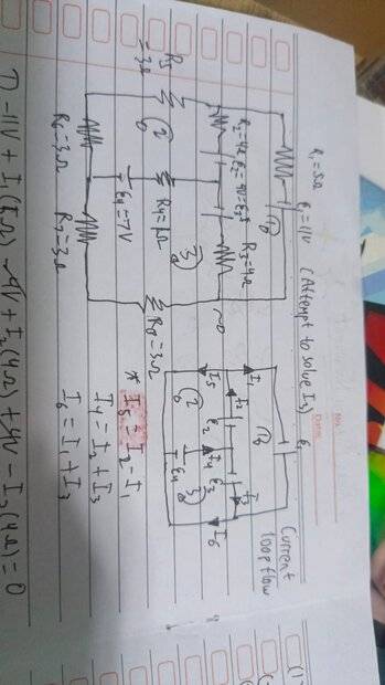

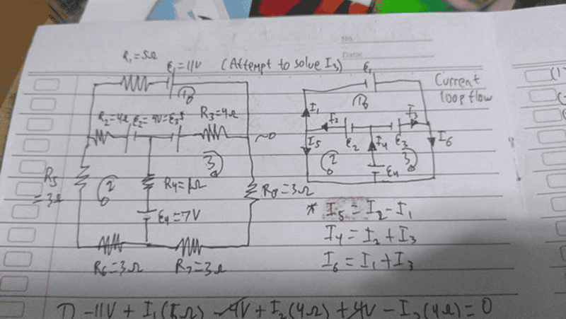

(Somehow, i can't rotate the pic here. Sorry for the technical difficulty)

To answer the question, yes I do. I feel uncertain after determining the loop equations. Im trying to find the value of I3, but kept struggling
You probably need to rotate it in the viewer before you upload it here.
Oh, thanks bro. Appreciate it. Now, can you help me solve it?

I just spot checked ##\circlearrowright_1##, your equation is coming out correct. I start at the node between ##I_1## and ## I_5## clockwise around the loop element by element:
$$ -5 I _1 + 11 + 4 I_3 -4 + 4 -4I_2 = 0 $$
$$ \implies 5I_1 + 4I_2-4I_3 = 11 $$
So I surmise you understand the branch/loop analysis, even though you're not exactly tackling it the way I am. The branch current direction you assume is to define the polarities across the elements. Then just go around the loop. Thats what I find is the easiest to check over. What was your method for loop 1?
Or do you mean you understand that bit, and are having trouble solving the resulting system of equations?

My method for loop 1 is actually choosing all of the 3 loops direction, and did a vector comparison with the current which is located at the center (In this case, $$I_2$$ and $$I_3$$ are the center despite $$I_4$$ is also a center, the vector between the second loop and the third loop went into the same direction).
From what I perceived, notice that the current of $$ I_2$$ according to the first and second loop respectively are directing to the same way, to the left. On the other hand, in the first loop,$$ I_3 $$ is moving towards the left while the third loop said it's moving to the right. Since there is an opposing current vector, I put the $$4I_3$$ to be a minus.
Anyway, I just cant solve the resulting system of equations. My equation turns out to be:
(Loop 1): $$ 5I_1 + 4I_2 - 4I_3 = 11 $$
(Loop 2): $$ -6I_1 + 11I_2 + I_3 = 11 $$
(Loop 3): $$ 6I_1 + I_2 + 11I_3 = 11 $$

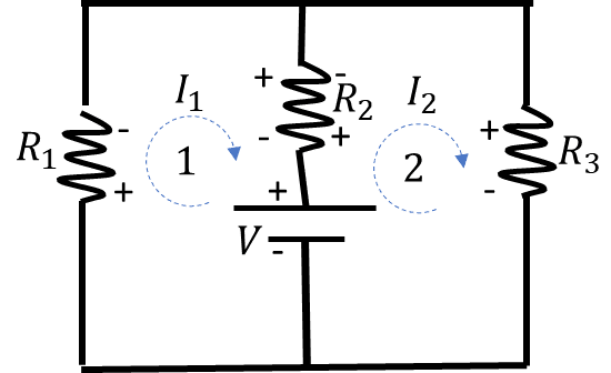

Superposition is a mathematical property of linear systems. In plain language, the way I understand it is the total effect is the sum of its parts, and the parts don't really care about what each other are doing by themselves. What you say as adding "vectorially" is the superposition principle at work.
The Mesh just pairs down the number of variables in your equations. I wouldn't call it quite simple in comparison but it is likely less algebraic manipulation. Have a look at the wiki on it, no sense in reinventing the wheel.
https://en.wikipedia.org/wiki/Mesh_analysis

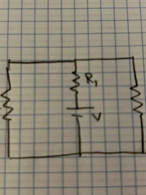

Something like this circuit is a good one to test, because there are probably six ways to Sunday to solve it and verify methodology.
Obviously just make up whatever values you want.

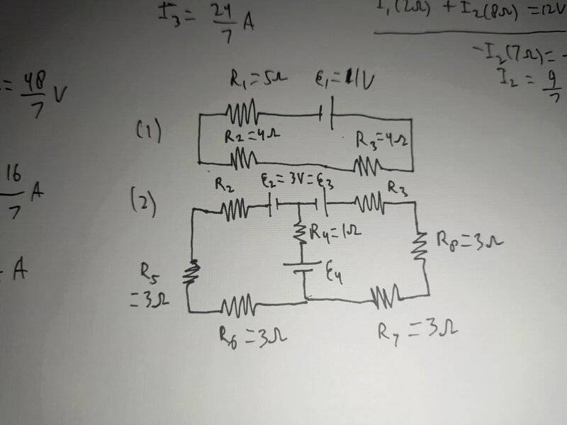

I believe there is a much easier way because of the symmetry.
First, what would happen if we were to replace the ##\epsilon_1## with a simple wire? What current would flow in ##R_1##? (The symmetry should allow you to say right away.) So what currents would flow in the lower two loops?
Now if, instead, we were to replace all the other voltage sources by plain wires. What would the current be in the top wire?
You now have the currents due to ##\epsilon_1## on the one hand and due to the rest on the other hand. Add 'em up.

Wire? As if in... Just a line? So you are telling me that I need to visualize the whole wire without its voltage source?
Like... This?

No, I mean two diagrams, one with only the ##\epsilon_1## source and one with only the others. Where a source is omitted, replace it with wire.
You also need to write in the voltage and resistance values to make the symmetry apparent in the second.
And you can simplify a bit by combining pairs of resistors that are in series.

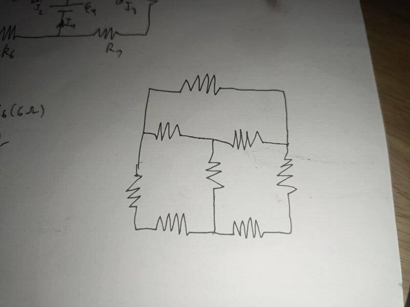

This?
eleking16 said:
If this is not what you're thinking of, can you draw it for me? Sorry if I keep asking, I'm a new guy, who doesn't know how to do loop circuits since the teacher told us to learn independently
