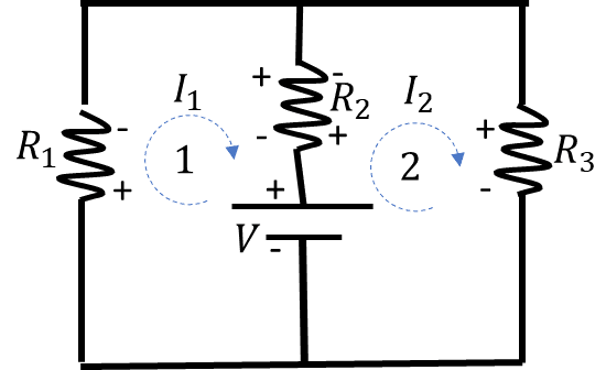

eleking16 said:
Alright, uhhmm.. I'm here again, and... I found no success in understanding how the mesh operation works. So, uhm... Can you guide me? :(
Circuit schematic with three resistors R1, R2 and R3 and a voltage source V, with two mesh loop currents I1 and I2 drawn as dashed arrows and +/- polarity marks on each resistor.
You define a loop currents for each loop that does not enclose another loop ## I_1,I_2##. Then go around the resistive elements and give them polarities based on the loop current direction. Voltage source polarity is fixed. Next apply KVL around a loop. I'll do the loop 1:
$$-I_1 R_1 - I_1 R_2 + I_2 R_2 - V = 0 $$
That is the equation for loop one. Notice that the where the loop currents "mesh" the contributions of voltage drop in resistor 2 are "superimposed"
Now you try loop 2 equation.
So it's uhhh...
$$ V - I_2R_2 - I_2R_3 - I_1R_2 = 0 $$

It should be involving ##I_1,I_2## there is no loop current ##I_3##. Think about how I got each of the terms in the equation for loop 1. Can you see where they come from?

## V - I_2R_2 - I_2R_3 - I_1R_2 = 0 ##

Very close, but check your signs. Notice the polarities across the resistor in the middle. They are different with respect to the direction of each loop current passing through it.
Oh wait, hm...
## V - I_2R_2 - I_2R_3 + I_1R_2 = 0 ##

Yes, that's it. So you are left with two equations in two unknowns for loop currents ##I_1,I_2##. you solve, and then realize that where in the circuit ##I_1## and ##I_2## mesh ( the branch containing ##R_2##), the loop currents must be superimposed.

The voltage drops across a resistor by convention So you imagine the currents going around the loop in the directions you chose for loop currents ( clockwise, counterclockwise ) and assign polarities for resistive elements with that in mind.

Well, just apply with care. Likely less variables to deal with algebraically, but still some thought required. Just don't forget that you directly find "loop currents" - a theoretical construct in this technique. Your question is asking for branch currents, so don't forget to mesh the loop currents if elements share loop currents.
