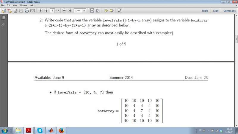

I am basing my code off a template I found in a textbook for using loops to create an array. If I didn't find this example I don't think I would even know where to begin with this. Here is what I came up with so far
Code:
levelVals = [10, 4, 7];
n = 2*size(levelVals,2) - 1;
m = 2*size(levelVals,2) - 1;
boxArray = zeros(n,m);
for k = 1:n
    for h = 1:m
        if k == levelVals(1)
            boxArray(k,h) = k;
        elseif h == 1
            boxArray(k,h) = levelVals(1);
        else
            boxArray(k,h) = levelVals(2);
        end
    end
end
boxArray;
Here is boxArray
Code:
boxArray =
    10     4     4     4     4
    10     4     4     4     4
    10     4     4     4     4
    10     4     4     4     4
    10     4     4     4     4
Basically I thought just to have an array with 5x5 dimensions and use loops to add elements to the array with the numbers desired.
... great, well done.
Did you have a question?
I notice the "boxArray" generated by your code is not like the one in the question attached.
It is better to understand things than copy code off some other source.

Yes, I am having difficulty making my code create boxArray to look like what it is supposed to look like. My question is how to write the for loop to make that array
I edited the prev post to get you a hint while you were replying ;)
I don't understand what your 4, 6, 5 > a(..,..) is doing. What is that doing, and why those numbers? Also, do you suggest I incorporate if elseif else end statements nested in my for loop?
This ended up doing it. I basically had to have the gsi hold my hand through the whole thing..this is frustrating as hell
Code:
n = length(levelVals);
boxArray = zeros(2*n-1,2*n-1);
for i = 1:length(levelVals)
        boxArray(i:2*n-i,i) = levelVals(i);
        boxArray(i,i:2*n-i) = levelVals(i);
        boxArray(i:2*n-i,[i,2*n-i]) = levelVals(i);
        boxArray([i,2*n-i],i:2*n-i) = levelVals(i);
end
Well done.
To explain what I did:
you know that a(1,1) =5 will make the top-left element of a into a 5?
then a(1:3,1)=5 will make the top three elements of the left-most row into 5's.
and a(1,1:3)=5 will make the three leftmost elements of the top row into 5's...
what I was doing was selecting the elements that needed to be changed as a block so there was no need to step through them like the gsi had you do.
So you'd want to do something more like:
Code:
clear
levelVal=[10,5,7]; %% an arbitrary input vector
n=length(levelVals); s=2*n+1;
for k= 1:n
  boxArray(k:s-k+1,k:s-k+1)=levelVals(k);
end
boxArray
... the last "boxArray" is to provide an output.
In the above example,
"clear" gives us a blank slate to work with.
n=3 so s=5
so k will go from 1 to 3.
when k=1, s-k+1=5
boxArray(1:5,1:5)=levelVal(1) will make a 5x5 array filled with 10's, and store it.
when k=2, s-k+1=4
boxArray(2:4,2:4)=levelVal(2) will make the middle 9 elements of the stored matrix into 5's
... see how this works? The square pattern is being built up like stacking blocks on top of each other.
when k=3, s-k+1=3
boxArray(3:3,3:3)=levelVal(3) will make the middle element into a 7.
You can experiment with indexing a matrix to get a feel for how it works.
