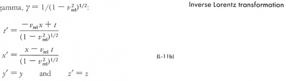

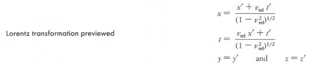

SUMMARY of below: I think Taylor is thinking velocity, but occasionally uses speed for velocity.
If he meant speed throughout, the statement on p111 below
[itex]v_{rel}[/itex] is treated as a positive quantity.
as a speed seems unnecessary. But I think he's saying that to remind the reader that the rocket has positive-velocity
[earlier on p111]
[itex]v_{rel}[/itex], stands for relative speed of the two frames (rocket moving in the positive x-direction in the laboratory).
So, I think Taylor really means velocity.
details:
While Taylor does use "speed" on Page 99 (bolding mine),
Think of a sparkplug at rest at the origin of a rocket frame that moves with speed [itex]v_{rel}[/itex] relative to the laboratory. The sparkplug emits a spark at time t' as measured in the
and again on Page 100
they do depend on the relative speed [itex]v_{rel}[/itex]
He used "velocity" earlier on page 97 (referring to equations on page 98.. screenshot below.. which are identical to those on page 102 [Eq. L-10b]) (bolding mine)
Following are the Lorentz transformation equations. Here is the [itex]v_{rel}[/itex] relative velocity between rocket and laboratory frames. For our convenience we lay the positive x-axis along the direction of motion of the rocket as observed in the laboratory frame and choose a common reference event for the zero of time and space for both frames.
The inverse transformation is (from page 103)
In his concluding paragraph on page 103, he says (bolding mine)
A simple but powerful argument from symmetry leads to the same result. The symmetry argument is based on the relative velocity between laboratory and rocket frames. With respect to the laboratory, the rocket by convention moves with known speed in the positive x-direction. With respect to the rocket, the laboratory moves with the same speed but in the opposite direction, the negative x-direction. This convention about positive and negative directions — not a law of physics! — is the only difference between laboratory and rocket frames that can be observed from either frame. Lorentz transformation equations must reflect this single difference. In consequence, the “inverse” (laboratory-to-rocket) transformation can be obtained from the “direct” (rocket-to-laboratory) transformation by changing the sign of relative velocity, [itex]v_{rel}[/itex], in the equations and interchanging laboratory and rocket labels (primed and unprimed coordinates). Carrying out this operation on the Lorentz transformation equations (L-10) yields the inverse transformation equations (L-11).
