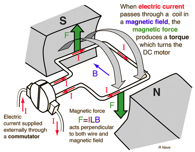

I'm building a system that is using the Lorentz force principle, of when a wire is placed in a magnetic field(##B##) with length(##L##) and has current flowing(##I##) there is a force = ##IL \times B## that would move the wire. I want to take into account of every single thing that will happen after.
  • Inductance in the beginning for current stabilization.
  • Induced-EMF, because there is change in flux due to the motion of the conductor in the magnetic field , ##\epsilon= -vBL## .
But, prior to motion there is something confusing me, when the wire has current flowing, it produces it's own magnetic field that is parallel to the exterior field and is in opposition, there will be induced EMF that is similar to motional EMF to oppose that change, however, is there a slight attractive/repulsive force between the wire and the exterior magnetic field source(magnet/electromagnet)? Similar to when two wires carrying current are placed near one another (depending on the direction of current) there is a force of attraction/repulsion.
How can a wire move in a magnetic field due to the Lorentz force, when it's own magnetic field interacting with the exterior field causes an opposing attractive/repulsive force? Although, the wire's magnetic field is parallel to the exterior one, but doubt that makes a difference. Bit confusing on that note.

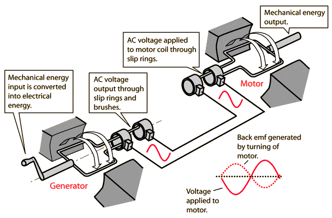

Well, for a motor for example, the wire is being mechanically driven by some means.
As the motor is turning, it also acts as a generator and generates a "back emf". By Lenz's law, the emf generated by the motor coil will oppose the change that created it. If the motor is not driving a load, then the generated back emf will almost balance the input voltage and very little current will flow in the coil of the motor. But if the motor is driving a heavy load, the back emf will be less and more current will flow in the motor coil and that electric power being used is converted to the mechanical power to drive the load.
http://hyperphysics.phy-astr.gsu.edu/hbase/magnetic/motorac.html#c2
I should have stated this earlier, but the circuit is DC. Also, so there is a force acting on the wire that is the Lorentz force, at the same time there is a repulsive/attractive force between the wire's magnetic field and the exterior's field?
Come to think of it... can the Lorentz force, be considered as a repulsive force...? The force that I was worried about is itself the Lorentz force and a magnetic force(maybe a repulsive force)?
To be exact of my question, aside from the Lorentz force the wire experiences are there any other magnetic force it experiences that could affect it's motion?
The only things that I can think of will always be Lorentz force, and the induced-EMF on the wire that is produced from this set-up, no other forces/effects come into mind.

In machinery the force is exerted on the conductors as shown in the diagram you posted.

I got myself confused, I assumed that the magnetic field produced by the wire and the external fields would interact in a way similar as to how magnets/electromagnets would attract or repel one another, which seems not true. I can conclude that the only force acting on the wire is the Lorentz force. I assumed there might be another force that would resist this. However, the only form of "resistance" that would oppose this change(the wire's motion) is the induced EMF ##\epsilon = -vBL##.
I have one thing to note here, when the wire creates it's own magnetic field it opposes the external field, would that decrease the external field causing a change in flux therefore having to deal with another induced-##\epsilon##, aside from the induced ##\epsilon## caused by motion? They way I think of it, is if the wire is stationary in that field there is no induced ##\epsilon## (ignoring inductance for a bit).
