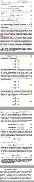

Please have a look on the attachment. For hi-resolution copy, please use this link: https://imagizer.imageshack.com/img922/7840/CL6Ceq.jpg
I think in equations labelled "12", 'e' is electric charge and Ex is the amplitude of electric field along 'x' direction.
How one could derive 14(i) and 14(ii) from 13(i) and 13(ii) respectively?
Thanks for the help!
  • Scanned page of a physics textbook showing numbered equations (12) to (15) on electron motion and Lorentz transformation, with equations for the transverse and longitudinal mass of an electron.
In the Einstein paper referred he said about longitudinal and transvers masses which are not used in current physics. If you are a first learner I do not recommend to go into that way though his physics is right and awesome.

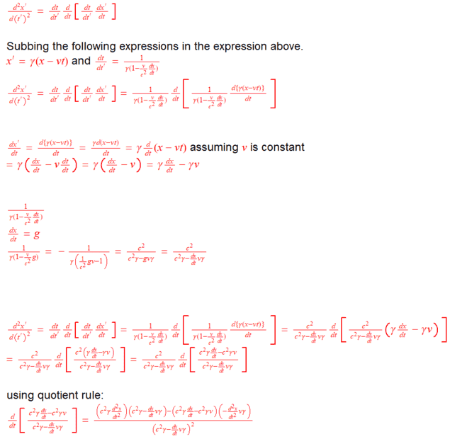

I tried to do it but getting '0' for the expression below.
[tex]\frac{dx^{\prime }}{dt}=\frac{d\left\{ \gamma (x-vt)\right\} }{dt}[/tex]
I'm sorry if I'm making some obvious mistake.

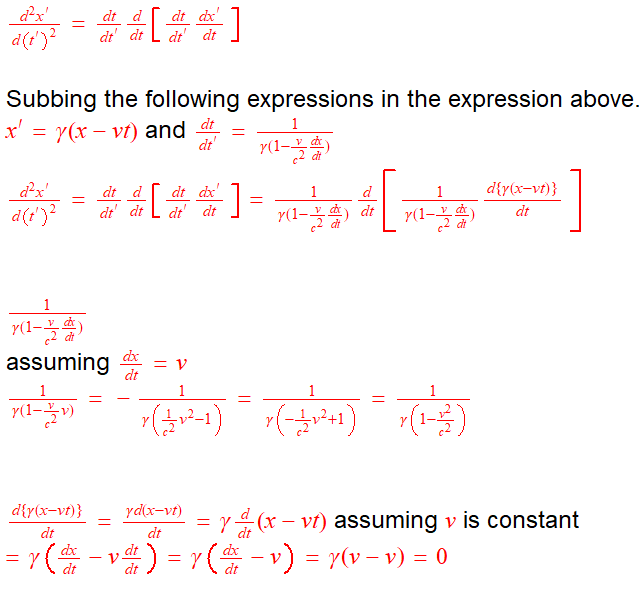

Shown below is my full attempt.
Handwritten-style derivation in red and black: d2x'/d(t')2 rewritten via chain rule, substituting x' = γ(x − vt) and dt/dt' = 1/(γ(1 − v·(dx/dt)/c²)), with dx/dt = v, simplifying to γ(1 − v²/c²) and finally to 0 for dx'/dt.
The mistake is at this point
Handwritten-style text reading "assuming dx/dt = v", with "dx/dt = v" shown in red.
You can't let ##\frac{dx}{dt} = v## until after you're done taking all of the derivatives.
It's sort of like making the mistake of finding ##f''(2)## for the function ##f(x) = x^3## as follows
##f'(x) = 3x^2##
##\therefore f'(2) = 12##
##\therefore f''(2) = \frac{d}{dx}f'(2) = \frac{d}{dx}(12) = 0##.

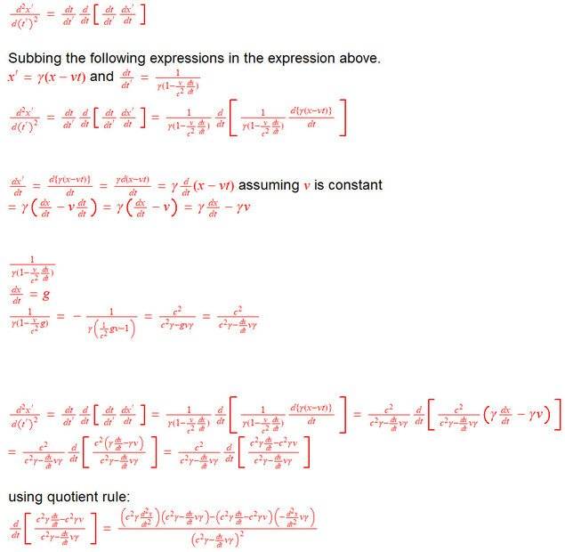

Do you think I'm on the right path?
Handwritten-style derivation in red of d²x'/d(t')² using the chain rule, substituting x' = γ(x − vt) and dt/dt' expressions, then applying the quotient rule to d/dt[c²γ dx/dt − c²γv] / [c²γ − (dt/dt')vγ].
  • Handwritten-style derivation in red of second derivatives under a Lorentz transformation, substituting x' = γ(x − vt) and dt/dt' terms, with a quotient rule step at the bottom.
Your work looks correct to me. There are places where you could have canceled some ##\gamma##'s between numerator and denominator. Also, there is a step where you multiply numerator and denominator by ##c^2##. I would not have done that, but if it helps you in the simplification, OK.
Good. So, now you have completed the differentiations ##\frac {d}{dt}##. You may now let ##\large \frac{dx}{dt} = v##. The smoke is about to clear :oldsmile:

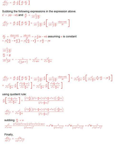

Do you think it's correct? What am I supposed to do next?! Thanks a lot for your help and time.
Handwritten red-ink derivation of a second derivative d2x'/dt'2 under a Lorentz transformation, using chain rule and quotient rule substitutions, ending with the result c4a over gamma times (c2 minus v2) squared.
You can check hi-res image here: https://imagizer.imageshack.com/img922/7309/8cHTMa.jpg
  • Handwritten-style derivation in red of second derivatives of x' with respect to t', using the chain rule, quotient rule and substitutions x' = gamma(x - vt) and dx/dt = v, ending with d2x'/dt'2 = c^4 a gamma / (gamma(c^2 - v^2))^3 style simplification.

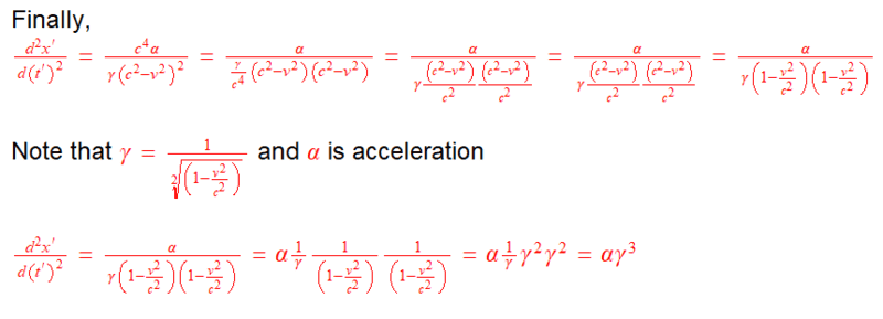

Looking good. In your final expression, multiply numerator and denominator by ##1/c^4##.

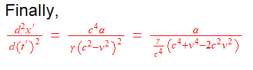

Thank you but I tried to simplify the end expression earlier before I posted it here but multiplying by 1/c^4 doesn't help.
Anyway, you can see it for yourself below. I'm sorry if I'm missing something obvious.
Handwritten-style equation reading Finally, then d²x'/d(t')² = c⁴a / (γ(c² − v²)²) = (γ/c⁴)·... rendered as a derivation step; equation with second derivative of x' with respect to t' equals c^4 a over gamma times (c^2 - v^2) squared, equals a over gamma/c^4 times (c^4 + v^4 - 2c^2 v^2).
##\large \frac 1 {c^4}## ## (c^2-v^2)^2 = ## ##\large \frac{c^2-v^2}{c^2} \frac{c^2-v^2}{c^2} ## ##= (1-v^2/c^2)(1-v^2/c^2)##
Express ##1-v^2/c^2## in terms of ##\gamma##.
Thanks a lot for your help and patience!
I think I got it now.
Handwritten-style derivation of d2x'/d(t')^2 = a/(gamma^3), with gamma = 1/sqrt(1 - v^2/c^2) and a the acceleration, shown as a chain of equalities.

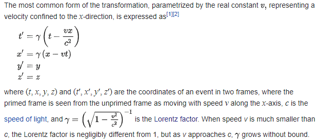

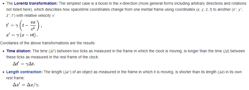

Note to self:
While deriving the expression above, the following relations were used as suggested by you.
Text excerpt of the Lorentz transformation for a boost along x: t' = gamma(t - vx/c^2) and x' = gamma(x - vt), with corollary formulas for time dilation, delta t' = gamma delta t, and length contraction, delta x' = delta x / gamma.
Source: https://en.wikipedia.org/wiki/Lorentz_factor#Occurrence
Text and equations of the Lorentz transformation for motion along the x-axis: t' = γ(t − vx/c²), x' = γ(x − vt), y' = y, z' = z, with γ = (1 − v²/c²)^(−1/2) defined as the Lorentz factor.
Source: https://en.wikipedia.org/wiki/Lorentz_transformation
