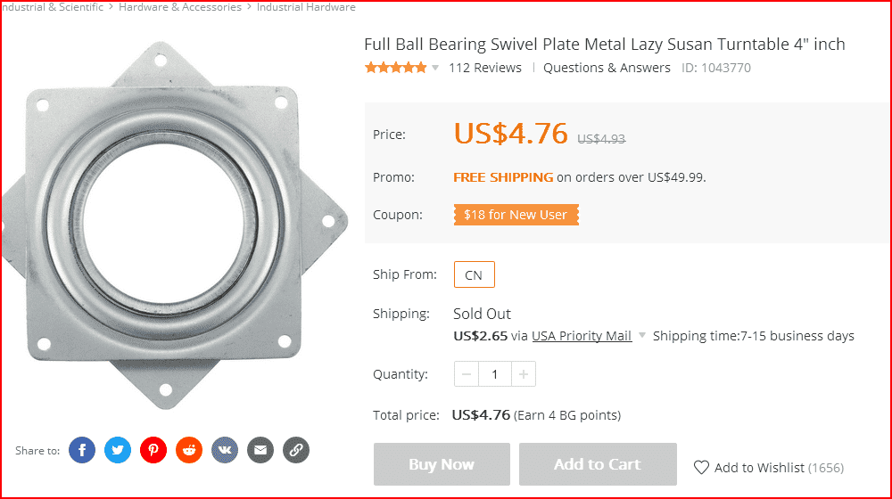

I am looking for a rotation devise like that one in this video below (from 00:40 seconds). Does anyone know where to get one, or have any idea about how to create a nice and stable rotation setup for experiments without too much hassle and DIY? A bike wheel won't do, a disk is better, because I need to know the moment of inertia from the shape of the freely rotating platform.
Turntable, lazy susan, potter's wheel, and record turntable are common names. Do you want a size and RPM similar to the video? There are many for sale on Ebay and Amazon.

I've built a few turntables for various things using the ball-bearing turntable bases you can get at large hardware stores. The picture below is a small 4" model, but I've used the `12" versions and they are pretty smooth and stable.
https://www.banggood.com/Full-Ball-...ntable-4-inch-p-1043770.html?cur_warehouse=CN
