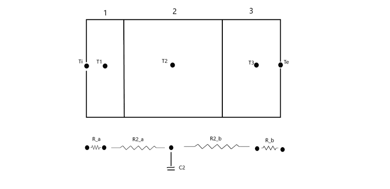

Jiec
Built the physical model (considering lumped capacitance mthod) of the three-layer wall, using one node for each layer placed at the centre of the latter, one node for the inner surface and one node for the outer surface.
The layers have conductivity k_i (for i=1:3) and thickness l_i (for i=1:3) and cross-sectional area A, only layer number 2 has a heat capacitance C2. The temperature of the inner and outer surface are assigned.
Then write the equations of the mathematical model.
R=l_i/(k_i*A)
Q=(T_i-T_j)/R
dQ=C_i*(dT/dt)
Hello,
I have some doubt on the representation of the physical model. I'm not sure about the number and value of the capacitance to be used.
I solved the exercise using this model (see figure) and i would like to know if the solution is correct or if there is something to fix.
Regarding the solution:
- R_a= R1/2
- R2_a=R1/2+R2/2
- R2_b=R2/2+R3/2
- R_b=R3/2
where R1, R2, R3 are the thermal resistance of each layer
- C2=l_2*A*c2
where c2 is hte specific heat of the second layer
For the mathematical model the equations are the following:
- (Ti-T1)/R_a-(T1-T2)/R2_a=0
- ( (T1-T2)/R2_a-(T2-T3)/R2_b )=C2*dT2/dt where dT2/dt is the derivative of T2 with respect to the time
- (T2-T3)/R2_b-(T3-Te)/R_b=0

Are you trying to find the temperature of mass 2 as a function of time? Is the system initially at a uniform temperature? Please fully describe the initial conditions of this wall.
Probably more questions necessary to further tease out your intent.
I need to find the temperature T1, T2, T3 as a function of time.
At initial time the system is at a uniform temperature (say 300K); the inner surface temperature rises to 900K in the first seconds (2 seconds) and then remains constant; the outer surface temperature remains constant (300K) all the time.
I am mostly interested in whether the model with resistors and capacitors is correct :)

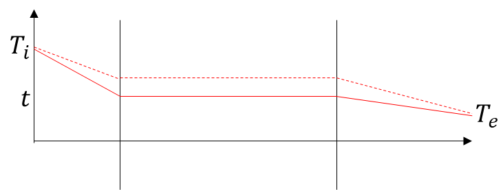

What do you end with for a solution for ##T## (the temperature of the chunk within the middle that can store heat)?
$$ M c_p \frac{dT}{dt} = \frac{k_1A ( T_i - T)}{\Delta L_1} - \frac{k_2A ( T - T_e)}{\Delta L_2}$$
Once you have ##T(t)##, you find the temp of the flanking walls in space and time, by noting that in the walls surrounding ##M## the temperature gradients are linear in space. So over time the temp profile moves from the solid toward the dashed (etc...) in this simplified model.

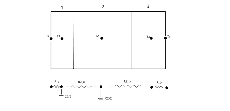

##T_{1}##, ##T_{2}##, ##T_{3}## are the temperatures of the section placed in the middle of layers 1, 2, 3.
My doubt is due to the fact that using the nodes shown in the figure the thermal resistances ##R_{2a}## and ##R_{2b}## consider the resistance of two layers and not just the layer 2. So I'm not sure if using one capacitance on the node 2 is correct or it is better to use two/three capacitances as in the following figures.

I don't know what the big deal is about using the circuit analogy. If the flanking walls have no mass they aren't accumulation their own internal energy, they are just passing it through the system.
Solve the ODE in post #4 to get the solution ( subject to boundary conditions ##T_i,T_e = \text{const.}## and ##T_o## the initial temp of the sandwiched mass ##M## ) The diagram at the bottom of #4 is the temperature profile throughout the system at a particular instant in time. Solving the ODE tells you how it changes as time progresses

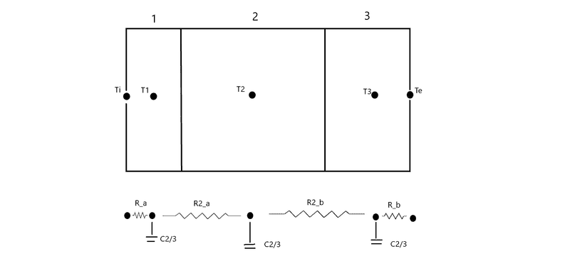

Probably i'm mixing up with a model that uses 3 capacitance when there is convective heat transfer on the external surfaces (but this is not the case)...do you know if there is a more refined model using always the same nodes?
If the capacitances on the left and right are zero, then this is the same as convective heat transfer on the left and right surfaces of region 2. So, at the left surface, $$-k_2\frac{\partial T}{\partial x}= h_L(900-T)$$and on the right surface, $$-k_2\frac{\partial T}{\partial x}=h_R(T-300)$$

With ##h_R## and ##h_L## do you mean convective heat coefficients? Because I don't have them; I think that the convective coefficients are high and so the inner and outer surface act as an ideal temperature source
Convective is mathematically the same as resistive without capacitance.
