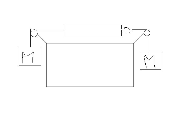

Another Q. about action and reaction
i don't know why the reading isn't 2Mg,but is Mg
Assume the strings are light and the pulley is smooth.
I don't understand what the first question is asking, but you can understand the diagram like this. Put a second spring and meter on the other side also, what does it read? (By symmetry, it reads the same as the first side, call this reading W.) Now put a nail through the box on the top, do any of its readings change? (No it still reads W, the reading is how much the string is stretched, it makes no difference if the box the springs are attached to is nailed down or not.) Now remove the second mass altogether, keeping the box nailed down. Does the reading change? (No, it was nailed down, it doesn't matter if the other mass is there or not.) What is that reading, what must W equal?
Analysis is correct.
