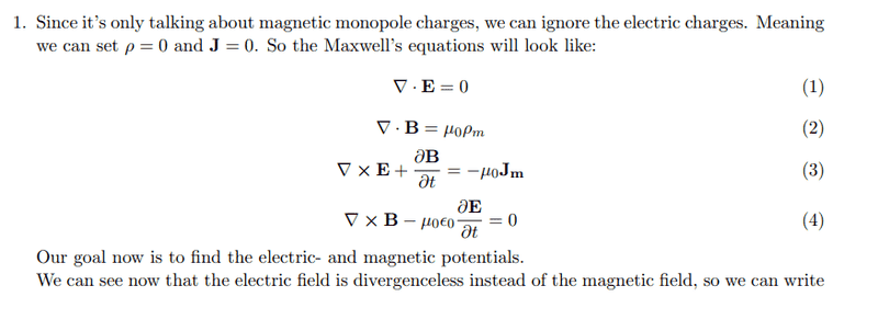

Find the magnetic- and field lines equations of a moving magnetic monopole charge at constant velocirty v.
Question:

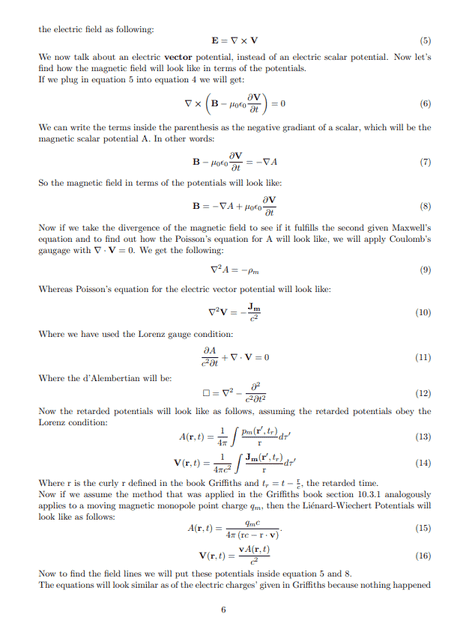

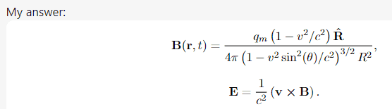

My answer:

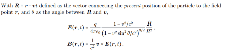

What it looks like for an electric charge:
Am I correct? If you want I can hand out my Latex on how I got to it, it will refer to the book Griffiths a lot.

You didn't show how you got these results. You can use dimensional analysis to see that these aren't correct.

I think my retarded potentials are wrong, because of wrong constants should for A(r,t) there to be a mu_0 and for V(r,t) instead of 1/c², an 1/epsilon_zero?
I haven't checked the details of your calculation using the approach of rederiving scalar and vector potentials for the fields due to magnetic charge and then using these potentials to derive the fields of a uniformly moving magnetic point charge (monopole). It looks tedious.
Another approach is to compare Maxwell's equations for electric charge with Maxwell's equations for magnetic charge.
For electric charge (with no magnetic charge present) we have
For magnetic charge (with no electric charge present) we have
For convenience, I've added the subscript ##m## for the fields due to magnetic charge.
These two sets of equations are equivalent except for symbols. For example, you can convert the first equation in the electric charge equations to the first equation in the magnetic equations by making the symbolic substitutions $$ \mathbf{E} \rightarrow \mathbf{B_m}$$ $$\rho \rightarrow \mu_0 \epsilon_0 \rho_m$$
See if you can find additional substitutions $$\mathbf{B} \rightarrow [?]$$ $$\mathbf{J} \rightarrow [?] $$ so that the other equations for the electric charge are transformed into the other equations for the magnetic charge.

So, the formula for the electric field of a moving electric charge is given to be $$\mathbf{E}(r, t) = \frac{q}{4 \pi \epsilon_0}\frac{1-v^2/c^2}{\left(1-v^2 \sin^2 \theta /c^2 \right)^{3/2}}\frac{\hat{\mathbf{R}}}{R^2}$$ It should now be easy to translate this to the expression for ##\mathbf{B}_m(r, t)## for the magnetic monopole.
Likewise, you can translate ##\mathbf{B}(\mathbf{r}, t) = \frac 1 {c^2} \mathbf{v} \times \mathbf{E}(\mathbf{r},t)## to get ##\mathbf{E}_m(\mathbf{r},t)##.

$$\mathbf{B}(\mathbf{r},t) = \frac{q_m \mu _0 \left(1 - v^2 / c^2 \right) \mathbf{\hat{R}}}{4 \pi \left( 1 - v^2 \sin^2 (\theta )/c ^2 \right)^{3/2}R^2},$$
$$\mathbf{E}(\mathbf{r},t) = -\frac{1}{c^4} \left( \mathbf{v} \times \mathbf{B}(\mathbf{r},t) \right).$$
This looks right.
The factor of ##\large \frac 1 {c^4}## is not correct. If you show your steps, we can find where you made a mistake.

Originally it was $$\frac{1}{c^2}$$ but because of the $$-c^{2} \mathbf{E}$$ transformation it became $$-\frac{1}{c^4}$$.
The transforms are ##\mathbf{E} \rightarrow \mathbf{B}_m## and ##\mathbf{B} \rightarrow -\mu_0 \epsilon_0\mathbf{E}_m##
Note that the second one can be written as ##\mathbf{B} \rightarrow -\mathbf{E}_m/c^2 ##.
So, when translating ##\mathbf{B}(\mathbf{r}, t) = \frac 1 {c^2} \mathbf{v} \times \mathbf{E}(\mathbf{r},t)##, I don't see how you get a factor of ##\large \frac 1 {c^4}##.

Oh I misread the formula I thought c² was y_o*e_o, so it basically becomes -v x B.
Yes, that's right. Good.

When you sketch the E-field lines of the moving magnetic monopole, be sure to take into account the negative sign in ##\mathbf{E}_m = -\mathbf{v} \times \mathbf{B}_m##.
