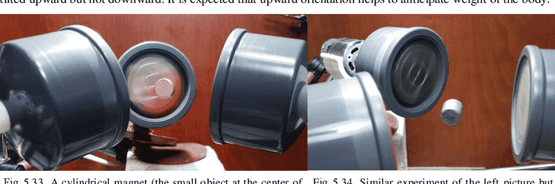

This is an interesting image from your paper. Can describe in just a few sentences what's going on?
In this experiment, three large rare Earth dipole magnets mounted in these drums, rotating in sync and poles orthogonal to their rotation axes generate a complex time varying field having local minimum which serve to trap another rare Earth dipole magnet in air. Under such a condition, a magnetic body tends to stay in a position where its kinetic energy is minimum. More accurately, this minimum energy level (potential well) can be expressed as Landau's "effective potential"[1]. This model is used to explain the Kapitza pendulum (the inverted pendulum having a vibrating arm). Kapitza pendulum"s equation of motion is a forced harmonic motion with parametric excitation and exemplified with "rotating saddle" effect. This equation in its linear form is known as the Mathieu equation where its stability can be evaluated by Ince–Strutt diagram.
Videos of these experiments and their configuration details can be found on the Sudanamaru channel.
Note that Kapitza pendulum can be also realized magnetically using a compass needle as the pendulum and an AC driven Helmholtz coil as the vibrator [2].
