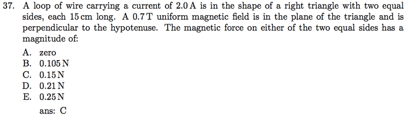

Hi,
For question 37 (attached), I found the length of hypotenuse to be ~0.21m by letting a2 + b2 = c2 which is simple enough. Then I let Fb = i L x B and since L and B are perpendicular this gives a force with magnitude ~0.3 N. Now, I realize the question is asking to find the respective force on each leg of the right triangle, so you divide by 2 to get the answer of 0.15N. Is this process correct?
Now I may be mistaken here which is why I'm posting this question, but isn't the force field created uniform? Why do we end up dividing by 2? Doesn't everything in this field experience a force of 0.3 N?
Also, shouldn't I also be adding the force from the other sides of the triangle besides the hypotenuse since there's current in the other 2 legs that increase the net force experienced by each side of the triangular loop?
Any clarifications would be great!
  • Text problem 37: a wire loop carrying 2.0 A shaped as a right triangle with two equal 15 cm sides in a 0.7 T field; answer choices A. zero, B. 0.105 N, C. 0.15 N, D. 0.21 N, E. 0.25 N, answer C.
Look at the statement of the problem carefully. It says the B field is UNIFORM across the triangle. That means that your only concern is the current in one of the equal legs. The other two legs and their current mean nothing.

Thanks for the clarification. Aside from that, is my process correct?
I doubt it, since for one thing you calculated the length of the hypotenuse which was totally immaterial.
All you need is to compute the force on one of the equal legs with the given B field.
Okay, the numbers seem to work out now, thank you. Just wondering, since the magnetic field is perpendicular to the hypotenuse with current flowing through it, doesn't it have any effect?
Once again, I may be completely wrong here but for the equation F = iL x B, isn't that the magnetic field produced by the current carrying wire, not the force it experiences?
Not if the problem states explicitly that the B field within the triangle is uniform. It's not your worry how it got there. Of course the hypotenuse current and the other two leg currents contribute to the B field, but that is not your worry. The B field is stated to be B and is uniform within the area of the triangle.
