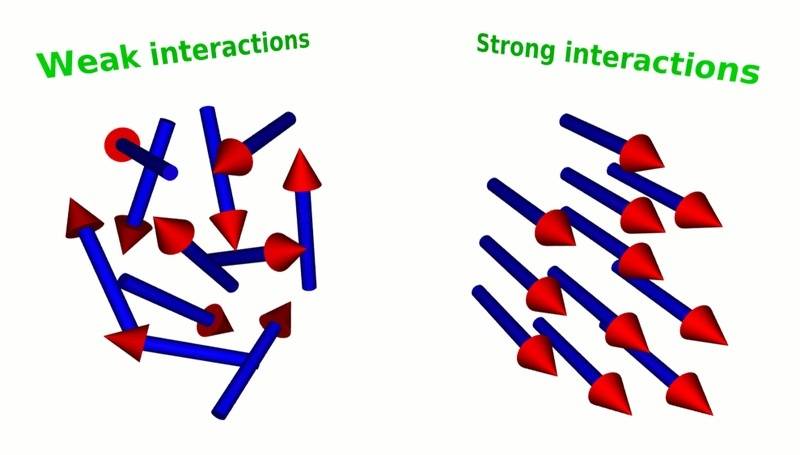

could you please explain me similar magnetism in bar magnets because their is no current running even out their then how there is a magnetism associated?
It has to do with the alignment of unpaired electrons and their spins.
See this article: http://en.wikipedia.org/wiki/Ferromagnetism
Because when the electrons are randomly arranged there is a very weak field, it is so weak that it can't be taken in consideration, because the produced fields have different directions so they cancel each other, but at a current all, the electrons are directed in the same direction producing a unidirectional field, same thing how ferromagnetic materials turn into magnets when affected by another magnet and then lose their magnetism when the effect of the other magnet vanishes
