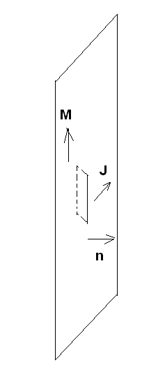

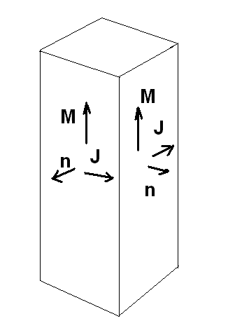

We have a very long ferromagnetic cylinder with square cross section, with side length a. Cylinder is homogeneosly magnetized over his volume so that the magnetization vector is parallel to the axis of cylinder. Cylinder is in vacuum. Find the current appeared in the cylinder because of the presence of the vector M. Find the vector H and B at the center of cylinder.
Since M=Jxn it means that current in the cylinder is equal to M by intensity with the direction shown in the picture
But i don't know how to determine H and B in the center of the cylinder, i mean i could use generalized Amphere's law to find H and then easily find B but i don't know how, because i don't see what kind of symmetry would work here. Could anyone help me out here?
There are two methods to work this problem: The first is by magnetic surface currents. The magnetic surface current per unit length is given by ## K_m=M \times \hat{n} / \mu_o ## (M.K.S. units). In this method you compute the B using Biot-Savart from these surface currents due to the magnetization. That method can be mathematically difficult. The second method, the magnetostatic pole method, works much easier for this problem. The pole method ignores surface currents, but instead has magnetic surface charge per unit area ## \sigma=M* \hat{n} ## where this is a vector dot product. The magnetic surface charges which are sources of H are simply on the endfaces ( "+" magnetic pole on one face and a "-" magnetic pole on the other) and for a long cylinder are negligible for most of the length inside of the cylinder. Meanwhile the magnetic field ## B=\mu_o H+M ## (Note this is a pole method equation-the surface current method does not have any magnetic poles or H due to the poles) and the ## H ## from the endfaces is approximately zero. The result is ## B=M ## inside the cylinder. A Biot-Savart calculation using the surface currents would get you the same answer, but the integrals to get the answer are very clumsy mathematically. There is one method I overlooked with the Biot-Savart type solution: Use Ampere's Law on the surface current ## K_m ##. That should get you the same answer as the pole method.

## \sigma ## is magnetic surface charge (magnetic pole) density. This method (the magnetic pole method), is a completely separate approach to the problem. The ## \sigma=M *\hat{n} ## is a dot product, so that the poles appears on the endfaces. The magnetic poles do not exist at all in calculations of the magnetic surface current method, where ## B ## is computed from Biot-Savart using the magnetic surface current per unit length of ## K=M \times \hat{n} /\mu_o ##. Here we have a vector cross product and the magnet surface currents (these are actually bound electron currents-these are not moving magnetic charges) circulate around the sides of the cylinder. These magnetic surface currents are used to compute the magnetic field ## B ## for this problem, both inside and outside the cylinder. I know even your teacher might disagree with this statement, but in the magnetic surface current formalism, there is no ## H ##. It never enters into the computation. Both methods get the exact same answer for the magnetic field ## B ##, but the correct interpretation of the underlying physics is given by the magnetic surface current method. The magnetic pole method is a useful mathematical shortcut that gets the right answer for ## B ##, but any physics explanation that it might supply can be very misleading. Also be careful not to confuse the terms magnetic surface "charge" and magnetic surface "current". They are two completely separate entities. (Just as the magnetic surface charges (magnetic poles) do not exist in the magnetic surface current method, likewise the magnetic surface currents do not exist in the magnetic pole method.)

I tried to find vector B using Ampere's law and this is it:
That little contour i drew is the contour on which i will implement Ampere's law, anyway, the general for of Ampere's law is:
## \int \vec H \vec dl = I_{through C} ## C is contour
## H2L=JL## where L is the length of the longer side of contour, and H exists only there due to right hand rule which means that magnetic field vector there is ##H=\frac{J}{2}## which means that ##B=\frac{\mu_{0}J}{2}## and this is not the same solution as yours, so i probably made a mistake, but unfortunately, i am not sure where exactly.
I need to make a correction to my post # 8. A fine detail, but an important one. In the pole model (and magnetic surface currents are non-existent in this model), ## H ## is computed from the magnetic poles with the inverse square law, and an additional ## H_a ## is added from any currents in conductors given by ## H_a=B_a/\mu_o ## where ##B_a ## is the applied ## B_a ## and ## H_a ## is the applied ## H ## computed from Biot-Savart. The equation ## B=\mu_o H +M ## is found to hold in all cases, and it gets the same answer for ## B ## as the magnetic surface current model. (Note that ## M## is a physical entity that is the same in both models.) Even though the ## H ## from the magnetic poles is totally ignored in the magnetic surface current model, and the magnetic surface currents and currents in conductors are the only sources of the magnetic field ## B ## in this model, the equation ## B=\mu_o H +M ## will still be valid in computing ## H ##. In addition, hysteresis curves of ## M ## vs. ## H ## will still be valid, even though the magnetic poles are not used to determine the magnetic field ## B ##. In the magnetic surface current model, ## H ## can be defined as ## (B-M)/\mu_o ## and it is completely mathematically valid. (It can even be used to compute the ## H ## from the poles.) Outside the material, (in the absence of currents in conductors), ## B=\mu_o H ## where ## H ## is the ## H ## from the poles. Incidentally, inside the material, since ## B=\mu_o H +M ##, ## \mu_o H ## is not the magnetic field. The ## H ## from the poles along with currents in conductors can still be used with the magnetic surface current model with a hysteresis curve of ## M ## vs. ## H ##, by computing ## H=(B-M)/\mu_o ##.
Let's first compute ## B ## from ampere's law: Around a rectangle where one long side is inside the cylinder and the other long side is outside the cylinder, ## \int B*dl=\mu_o * I ## where ## I ## is the current through the rectangle and is given by ## I=K_m * L ##. (The surface current per unit length ## K_m=M/\mu_o ##). ## B ## is assumed to be zero outside the cylinder. The result for the integral around the rectangle is ## B*L=\mu_o*K_m*L ## where B is the B field inside the cylinder in the +z direction. ## K_m=M/\mu_o ## so that ## B=M ## and points in the +z direction. ## H ## can be computed (see post # 12) and is ## H=(B-M)/\mu_o =0 ##. Additional item: Your equation ## \int H*dl=\mu_o *I ## is valid but the current ## I ## in this equation is only that of currents in conductors and does not include magnetic surface currents. In the equation ## \int B*dl=\mu_o *I ## , the ## I ## in this equation includes both currents in conductors and magnetic surface currents. Thereby, if you use the ## \int H*dl=\mu_o *I ## equation to compute ## H ##, you will get ## H=0 ## just as computed from ## H=(B-M)/\mu_o ##.

There is an equation in magnetic theory that says ## B=\mu_o H+M ## . The mathematics is somewhat advanced here, but you can take the curl of both sides of this equation and the result is ## curl B=(\mu_o)( curl H) +curl M ##. Now ## curl B=\mu_o J_{total} ## (Ampere's law in differential form) where ## J_{total}=J_{free}+J_{magnetic} ##. Also, ## curl M=\mu_o *J_{magnetic}## where the ## J ## represents current densities. (This curl M equation along with Stokes theorem is where the equation for the magnetic surface current per unit length ## K_m=(M \times \hat{n})/\mu_o ## originates) These equations are integrated over a surface area and Stokes theorem is applied. The result is ## \int B*dl=\mu_o *I_{total} ## (Ampere's law for ## B ## in integral form) where ## I_{total}=I_{free}+I_{magnetic} ##. (## I_{free} ## is the current in conductors). The other thing that comes out of this mathematics is the equation ## \int H*dl=I_{free} ##. (Ampere's law for ## H ## in integral form). Note: ## I_{free}=0 ## here. The magnetic surface currents can be used with the ## B ## equation (Ampere's law with ## B ##) to get the result that ## B=M ##. (The equation for ## B ## includes the magnetic surface currents.) When the ## H ## equation (basically Ampere's law with ## H ##) is used, since it only contains ## I _{free} ## which is equal to zero, the result is that ## H=0 ##. The magnetic surface currents are sources of ## B ##, but unlike the free currents, the magnetic surface currents are not sources of ## H ##. The mathematics here was somewhat advanced, but I think you should be able to work the two equations that emerged: ## \int B*dl=(\mu_o)(I_{free}+I_{magnetic} ) ## and ## \int H*dl=I_{free} ## where the integral around the loop is the current through the loop for these two equations.

That is correct. There are actually two different M.K.S. definitions for magnetization ## \vec{M} ##. (They differ by a factor of ## \mu_o ##). If the equation , (and definition of ## \vec{M} ##), ## \vec{B}=\mu_o(\vec{H}+\vec{M}) ## is used, surface current per unit length ## \vec{K}_m=\vec{M} \times \hat {n} ##. ## \\ ## If the equation, (and definition of ## \vec{M} ## ), ## \vec{B}=\mu_o \vec{H} +\vec{M} ## is used, ## \vec{K}_m=\frac{\vec{M} \times \hat{n} }{\mu_o} ##. ## \\ ## The problem can be solved by Ampere's law, (if it is assumed ## B_z=0 ## outside of the cylinder), but the pole method, with no poles,(which are sources of ## \vec{H} ##), for a very long cylinder gives, (because ## \vec{B}=\mu_o (\vec{H}+\vec{M}) ## and ## \vec{H=}0 ##), that ##\vec{ B}=\mu_o \vec{M} ## immediately.
