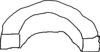

Hello,
I would like to know what is the magnetic field of a half toroid.
Would we use Ampere's law? So, considering that the integral is equal to BA, we would have BA = μo * i, then B = (μo * i) / r. But, using Biot-Savart's law, by symmetry, it seems that the vector sum of all the differential magnetic fields is zero.
What is the true answer for this problem? How can I find it? Where are my mistakes?
Thank you!
Just to be certain: cut in half which way? Air core? This is likely not simple.
I will show an image.
